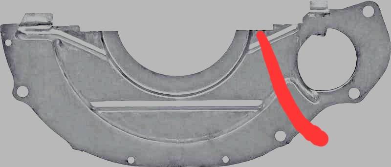

Can anyone foresee any problems with cutting the torque converter dust shield on a line across where the starter mounts?
Reason being I'm chasing down an oil leak that I think is coming from the oil filter plate (small block) but I'm double checking it's not the rear main. I've removed the dust shield but that requires removing the starter. Not a major operation but still a pain to get to the top bolt. Now the cover is off I need to reinstall the starter to check for the leak, then assuming it's not the rear main (it looks dry up there), pull the starter again to reinstall the cover and then reinstall the starter again. Pain in the butt.

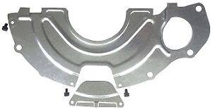

I'm thinking if I cut the cover I can reinstall the small piece and the starter, and then a 2 minute job to reinstall the main piece of the shield at the end. It will also make future maintenance easier (e.g. checking torque converter bolts if suspected to be loose).
I notice some aftermarket shield have an inspection cover built in for this purpose.
My only concern is the cover bending in slightly and hitting the converter if it's not all in one piece.

I have cut them. I have also run without them.
No gravel roads though!
Just leave it off. It's got to come aprt to fix the leak anyway.
Doug
My stock 64 318 poly has the small built in inspection cover, the 318 I removed from my 62 had it as well, might have it somewhere.
What about welding a small tab to the inside of the starter side, or outside of the larger piece, to keep it from bending in towards the converter?

The shield is cut and is still very rigid so no worries about it bending in.
I've just got to wrestle the starter back in and check that it's not the rear main.

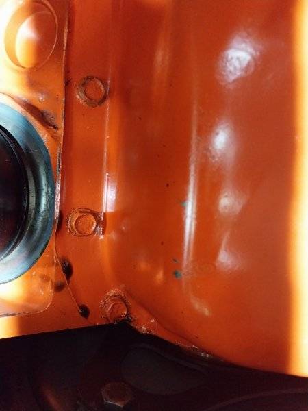

Well it is 100% coming from the oil filter plate which I could have discovered without pulling the starter and dust shield but where would the fun be in that?
I wouldn't usually be happy with an oil leak but to see that oil running from the plate and dripping off the sump rail while the rear main remained dry brought joy to my heart.

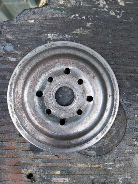

I've just finished putting it back on. Cleaned up the surfaces, drilled some extra holes in the plate for extra oiling, and put a thin smear of Ultra black around the sealing surface and torqued it to 30 lbs/ft. The gasket was new (new stroker build) so I've re-used it.
I'll try it tomorrow once the sealant is cured but I'm confident it won't leak. If it still does I think I'll get one of the billet ones from Summit.
I ended up drilling 4 more holes but now I've noticed the later ones only had 6 holes. Hope I haven't stuffed up.
