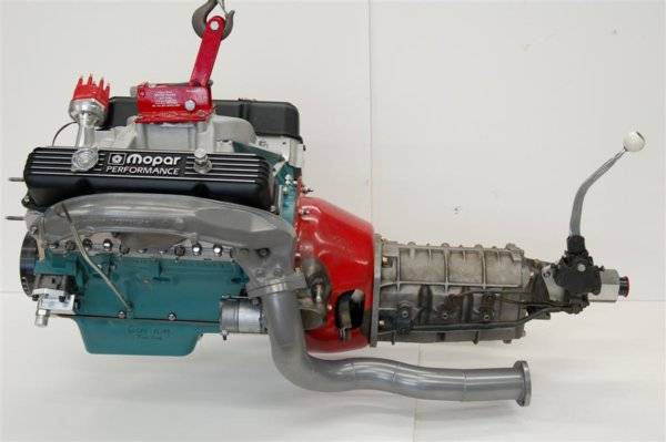

I use the Mopar 452 head which is a straight plug version of the Performer RPM. Those work just fine with HP manifolds. The angle plug heads will work with HP manifolds but the #6 plug wire get close to the manifold. If you run that combo you'll need to spend some time wrapping the wires and/or making some looms to hold them in place.

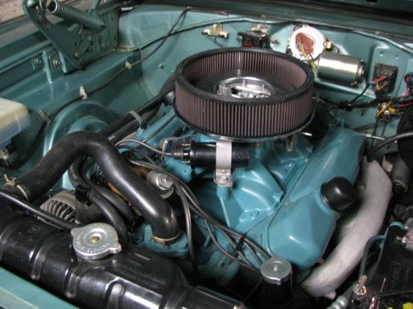

I have used many sets of Stealth Heads out there for many years, too numerous pairs to count and some now well OVER 40K Miles !
NO problems that I've heard back on ? and I am certain I would have by now.
just say'in....
IMO, you may have been plagued by some other/Geometry gremlin ?
BTW, for the guys that MUST retain that "stock" appearance....
Using the Stealth's(ported of course), we've Dyno'd 500+ HP and 565 Ft/Lbs on a 451 dressed as a factory "383 R/T car" through the factory hp manifolds and 2 1/4" Exhaust, Twin Snorkel Air Cleaner ON, 91 Octane using a .525" Lift HR Cam.
Which speaks to the rationale....
if you are using the factory HP manifolds for stock "appearances" ?
Then,
the Stealth's can also be used to provide excellent power !
I'll dig out the Engine Dyno Sheet and get it up here later/tomorrow.
