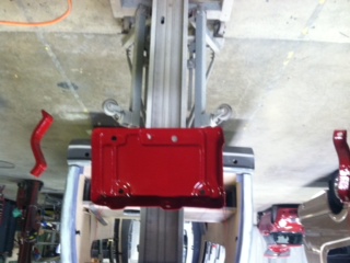

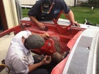

Here is an update. Pulled engine, did a total rebuild, replaced lower radiator support, rebuilt clutch z-bar, prepped and painted engine bay, and had exhaust manifolds ceramic powder coated. Will post more later.
View attachment 223471View attachment 223472View attachment 223473View attachment 223474View attachment 223475 Good Help.JPGView attachment 223477View attachment 223478View attachment 223479View attachment 223480View attachment 223481
Looking great. Nice thing your doing for your dad. Good luck with the project.
Nice color and having it they way one was so long ago is just cool!
Great progress and a nice thing you are doing for your dad!
Great job so far and a great cause too . . . Following along to see that you reach your goal . . . G'luck with it . . .
Funny how a little shine makes things a whole lot prettier!

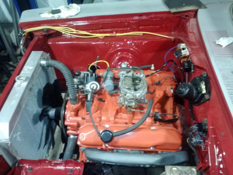

Engine In
Engine is in and looking to fire it up this week! The car did not come with a fan shroud, should I put one in? Not sure if that was standard in 69 for the 383's?
The car looks great - nice job! :icon_thumright:
As far as a fan shroud - YES, you should absolutely put one in. Fan shrouds are critical to helping funnel air through the radiator, which is what you need to help heat transfer. Without a fan shroud, a lot of air will escape around the radiator, and you may have overheating problems.
X2!! Get the shroud!......
You'd be amazed how many "car is running hot/overheating" threads that have come and gone on this site, only to see the person having problems post's pictures of their ride with no shroud under the hood.

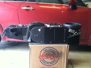

Finished up the Heater Box Resto and pretty happy with how it turned out! Got the RR in the shop for rear end service and a much needed alignment. Should be drivable as soon as it's done. One step closer to my Dad taking it to his first cruise in. Here's some pics of the Htr Box finished.
Looking good, that engine compartment sure looks great! X2 on the shroud
Looking great!! And i have to agree with the fan shroud, Yes sir you should have one...
