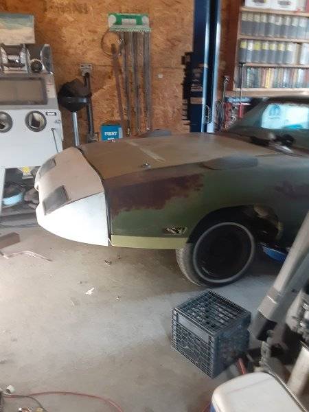

I have a Dayclona kit for a Daytona. Just now putting it together. Got it a long, long time ago 15/20 years? Does anyone have and info on the light bucket assy? thanks Stuart from Foxboro, Mass
ok will do, Also purchased some new fender seals and they say they don't come with the metal strips? does anyone have a picture of them? Probably will have to make some. Thanks
Most people extend the factory 70 Charger pieces. If you use them the top section is already made. I would probably use a second set of original 70 Charger pieces,flip them left to right and cut them to fit. You can see in this picture of my car where the factory 70 Charger fender seals end.
If your talking about the seals. I ordered a set of seals that said they where for a Daytona. We will c when they come in.
I never was able to post pictures at dodge charger .com. So here I am! But I still visit the website on occasion.
I was referring to the metal pieces that hold the seals onto the fenders. The stock 70 Charger pieces will hold the upper part of the Daytona fender seals in place,then using a second set of the 70 Charger metal pieces, flipping them upside down and left to right and cutting and shaping them to ft to the lower part of the valence pan to keep the Daytona seals in place.
Thanks, does anyone repo them? Or a salvage yard?
I don't think anyone reproduces them, but if they did, I would check with Charger Specialties. Probably more of a swap meet item, unless you know of any yards that have 70 Chargers in them.
Actually the same style of channel that holds the nose gasket on also holds the hood to nose 50" in gasket on, Its a small c channel. so now I have a sample so I can make it.
