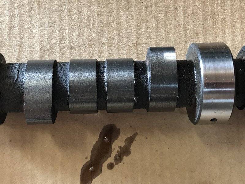

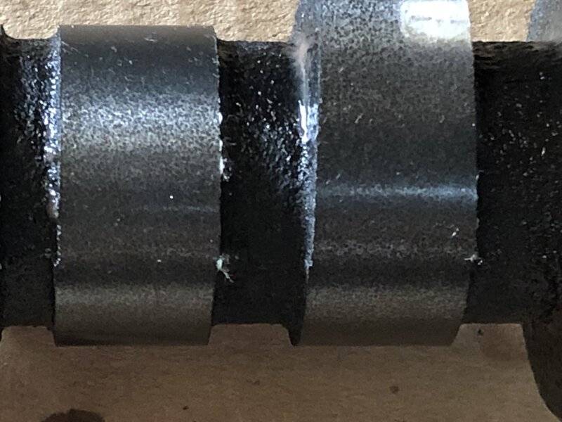

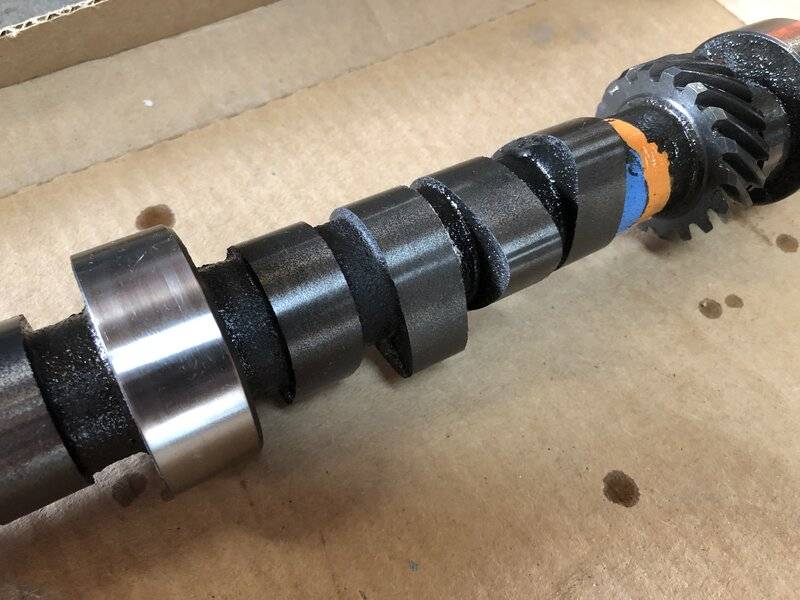

For those of you that have stumbled into my thread about the build of my wrecked 1970 Charger XH, I am rebuilding the original 383. The crank and pistons are in and yesterday I started to install the cam.
It is a Comp Cams 270/470 Magnum series.
I was slathering on the cam lube and as I was smearing it on with the cam lobes in my right palm, I felt some rough unfinished edges that cut my hand a few times.

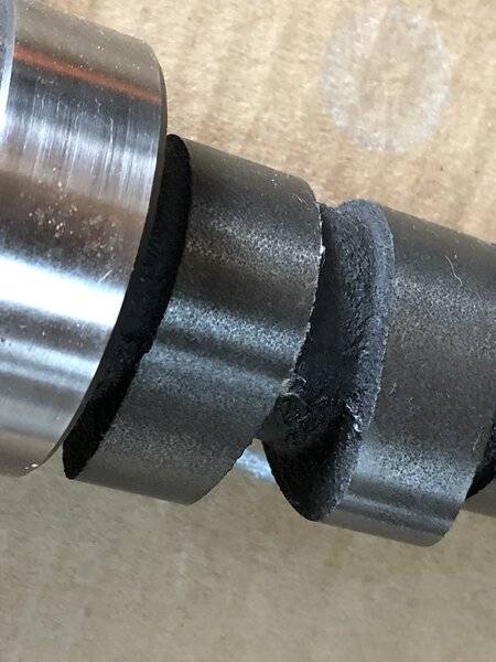

Take a closer look. You will see at the edges of the lobes, some fabric remains where I used a towel to clean off the lube.

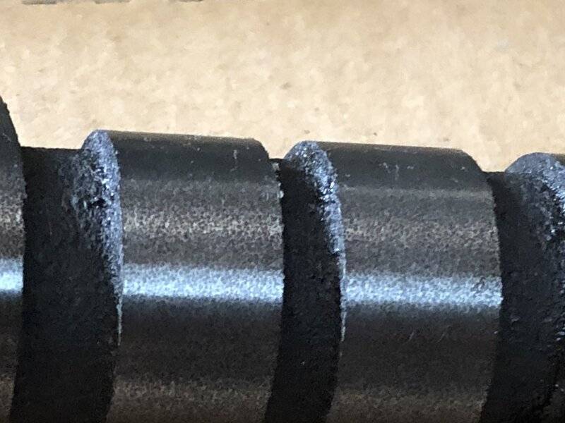

These spots are right on the outer edges.

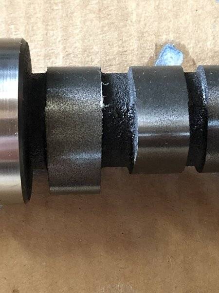

That one above was the worst.

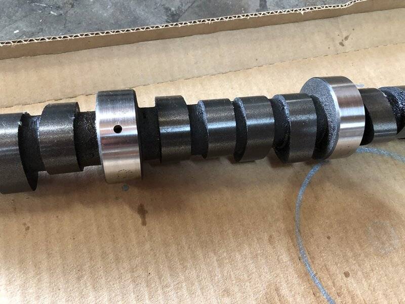

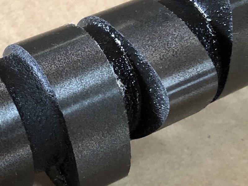

The lifters ride along the middle and edges of these lobes. I thought of just taking a file to the edges but what if I cut through the hardening treatment? Why should I have to do that anyway?
I haven't seen this before. I've installed maybe 20 cams over the years and this is the first one that I have seen like this. 7 of the lobes have sharp, raised edges on them.
I don't know that I would necessarily call it defective, but it sure is poor quality.
What if someone installed the cam and then coated it with the lube? They would have surely chewed up the lifters on the 7 bad lobes.
Looks like the typical junk that Comp Cams is making these days. They have really gone to ****. They'll never get another dime from me.
Their roller lifters are junk as well as their roller rockers. Not just Mopar stuff but GM and Ford stuff too.
Looks like the grinding wheel was positioned too far to one side.
I don't even like the looks of the lobes, like the casting didn't clean up.

Comp = junk... Kern the same thing happened to me, but the casting flash was so bad that if the cam slid fore and aft say .040 the flashing on #1 exhaust would actually snag intake lifter as it rotated. had to send back to comp and they dressed the sides up. That was last comp product I will ever use. Send it back
That is what I thought too. As the cam rotates, that edge would chew into the side of the lifter.
