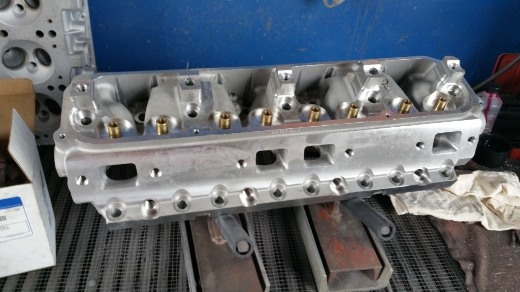

Let the porting begin... I can just smell the Horsepower. .
Sorry, wouldn't upload last night.. May be able to save internal pick up, YEAH!!

So what HP range you shooting for?
600ish.. I may overshoot that. Should allow me to put in a milder cam

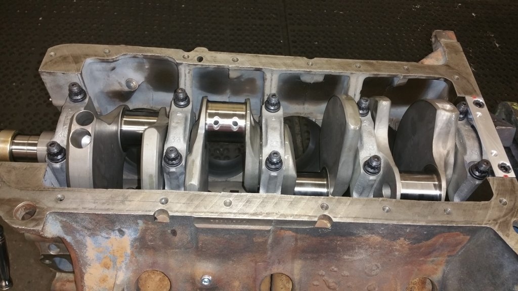

Crank, Rods and Pistons are stuffed into the block. Should be a Long Block by late next week.
