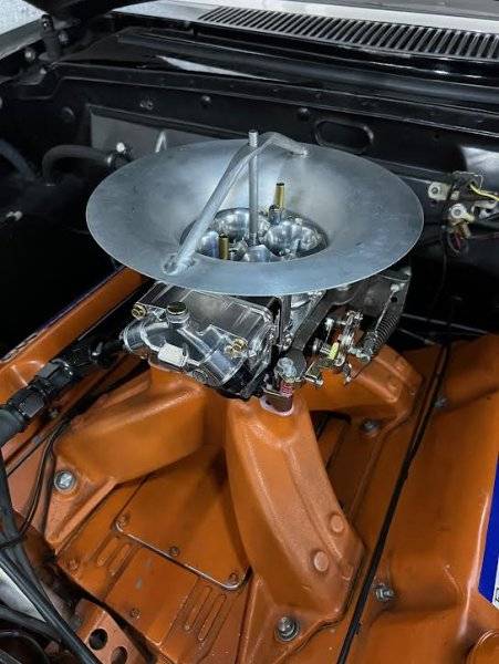

By the way guys, I have an aluminum lifter valley inspection plate and not the traditional closed thin tin valley pan from years back. If I pull the fold, what are your choices for the best manifold gaskets/sealers. There's lots of new stuff out there almost overnight, I can't keep up.

dry as in No heat crossover? I never heard of that term. Manifold is an open plenum Edelbrock Victor. Mini tunnel ram as I call it.
That's what I meant by dry. No physical connection to wet oil like a factory pan.
No where to suck oil other than the bolt holes
