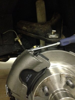

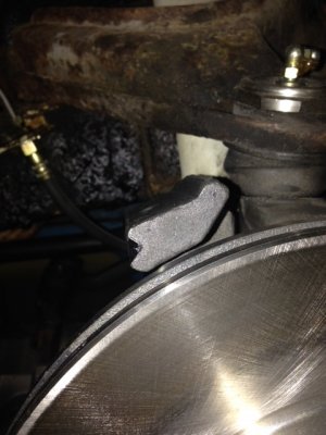

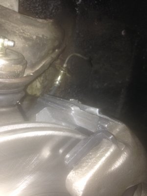

OK guys. I need some help. I started a previous thread to discuss the calipers not floating on the machined ways of the support. The Ram Man will not answer my phone or emails so I'm relying on you guys to help me out. I am going to attach a couple of pictures. You will notice the machined ways are a little different, one has a groove cut all the way around the other doesn't. The support that does not have the machined ways is the one the caliper is hung up on and won't slide. I'm assuming I have one wrong support.

The screw driver is inserted to show the gap. Basically the retainer is wedged against the caliper and won't lie flat.

The drivers side has the caliper mounting bracket with groove cut all the way around the machined way area. On this side the caliper slides fine. The passenger side, if you look at the picture, the upper way does not have the groove cut around it. Don't know if that is important or not, but it is different than the other side and this is the one where I can't get the retainer clip to go all the way down, without binding.

thanks for the clearer picture...am at a loss also for a quick explanation...only thing I could say next I am sure you have already checked and possibly checked yet again..but here goes..comparing left and right bracket..(with a tape measure)....any significant difference?
