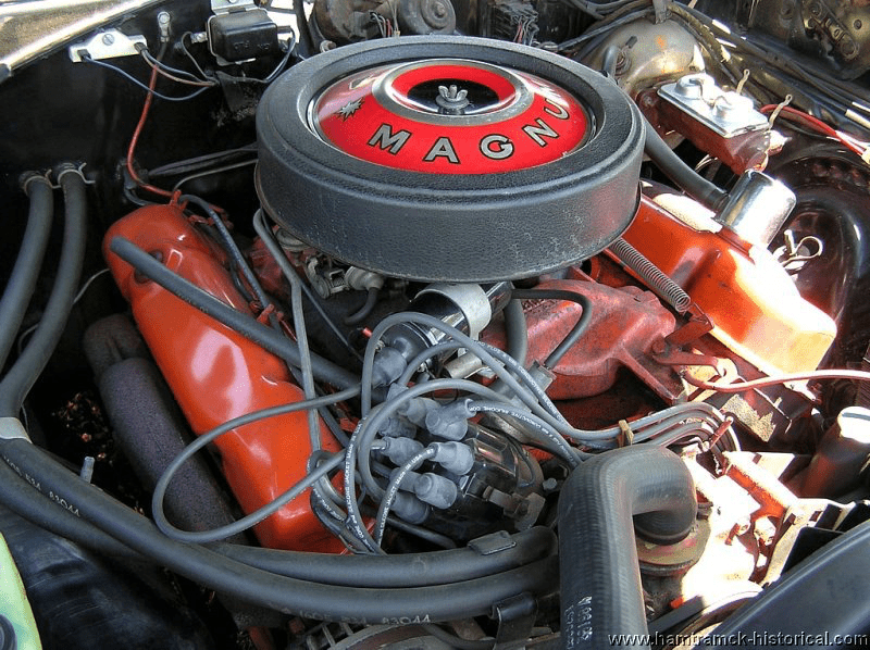

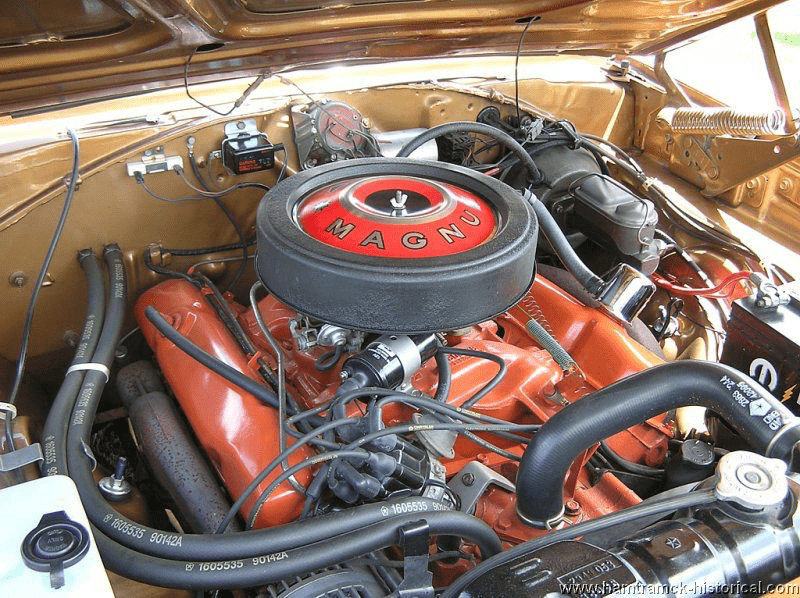

from Hamtramck
The 1970 Hamtramck Registry Library Page (1970 - 1974)
They started Black ( 1960 ) , went to Beige / Tan in
1966 ish , Went back to Black in 1969 / 1970 ish…. Depending on which Plant’s Assembly Line it went down…
