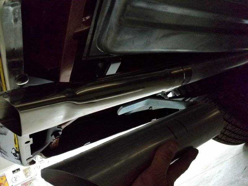

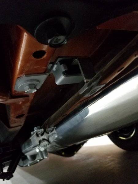

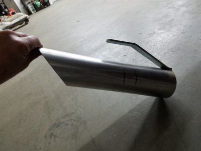

I cut off the TTI ends and use Accurate tips just because I like them better. They both mount through the same hanger bracket.
That mounting hole where you bolted it to the frame rail is not there on mine...
Although, maybe since it was not used before as my car had side pipes it might still be there but completely covered below the tar coating.
Need to double check.

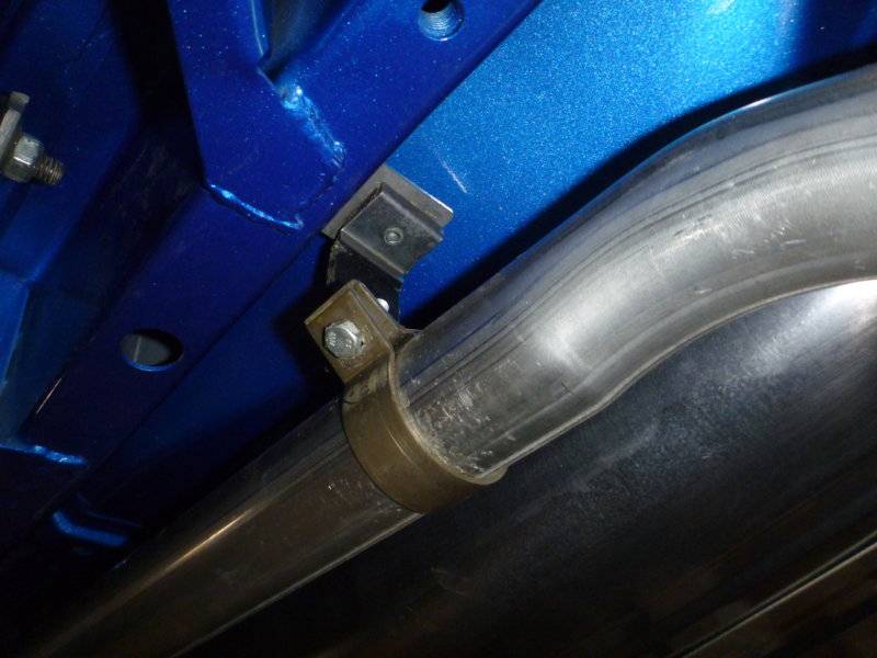

If you are missing the hole with nut on the inside of the frame like I have, you probably didnt have factory dual exhaust with tips. I think @dadsbee has the style hanger on his car that you would have had? He probably has a pic all ready to go to show you, lol.
What are you inferring Joel.. LOL You can see the "Chrome TIP" hanger threaded hole in the frame rail just after of my turn down hanger brackets..
I found the bolt hole, it was exactly as your picture showed.
The bottom of my car is covered with a tar coating, after some poking around i found the holes, went through it with a 7/16" tap and good to go!
Edit: You guys are just showing off these beautiful painted bottoms with no ****, grime and tar....i need to dig around through this greasy **** here!! :D

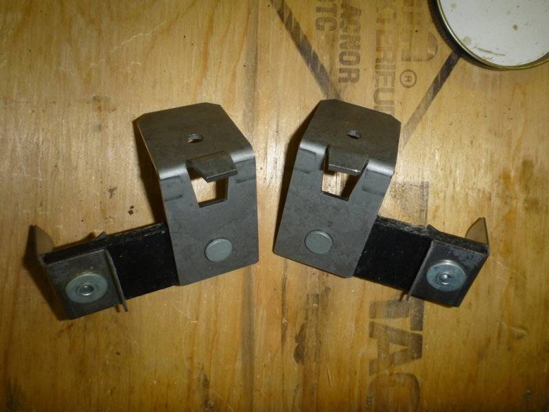

The below brackets are the same as under my car, just the metal bracket though.
