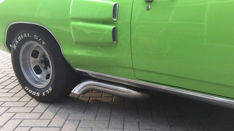

Previous exhaust was a 3" with 2 mufflers and 4"!! side pipes.
Speaking loud....
Speaking loud....
:eek: holy crap! Sewer pipes.... :)

Yes sewer pipes.
The drone was not nice.
It sounded awesome though but too loud for cruising around.

Yes sewer pipes.
Walker still makes exhaust nowdays but all i've seen are like common, stock replacement exhausts.
View attachment 915951 View attachment 915952
Woah those babies are nice! Yeah I image the drone down Main Street would get annoying after only a few minutes

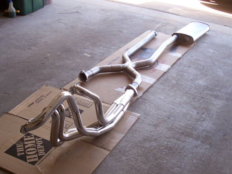

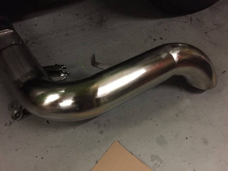

The '71 Charger has the TTI 3" H-pipe system with the Super turbo mufflers. It sounds good, and quieter than most other performance mufflers, but not quiet.
There is also the difference between a nice mandrel bent exhaust system, and the common muffler shop systems with crimped bends.
The Charger originally had a 3.5" exhaust system with race bullet mufflers, and turn downs before the axle. It sounded like open headers below 3,000 RPM, above that it was just a smoother open header sound. At idle it would set car alarms off just at idle.
I got tired of the noise, and used the full length 3" mandrel bent system (TTI), and it made no difference in performance (when I was only running 12.50's), but was much quieter.
I think the crimped bends on the 3.5" exhaust made the tubes flow worse than the 3" tubes.

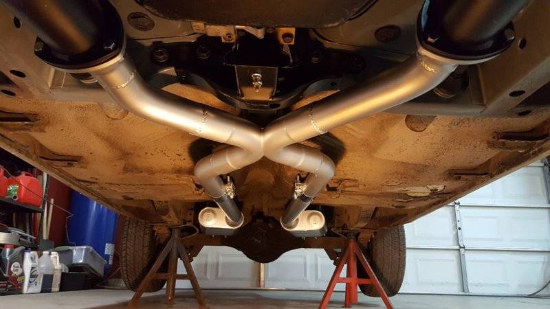

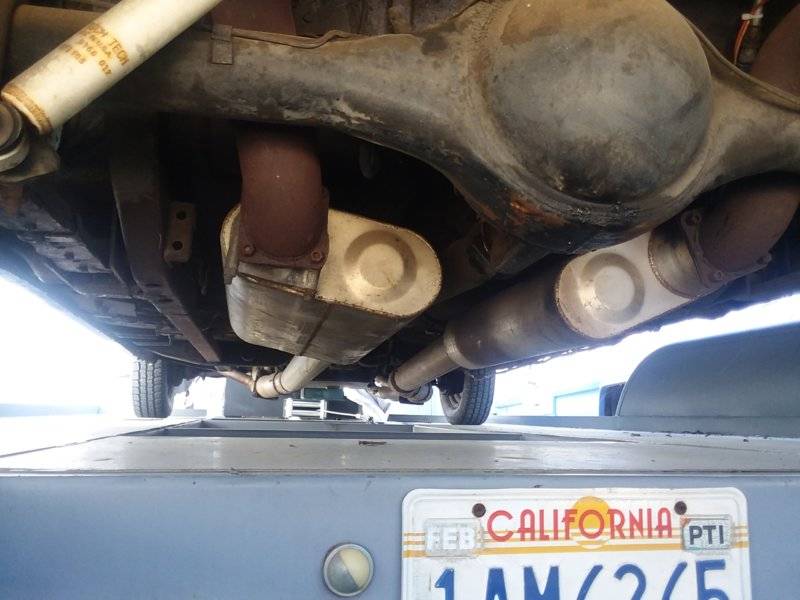

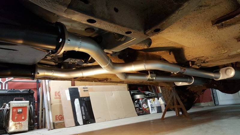

I stand by my recommendation in post 15, but you asked for BTDT. The under chassis shot is my 62, built for the next combo, a 522 nitrous engine. 3 1/2 mandrel bent, in and out, 3 1/2 series 50 flowmasters, tailpipe s to the bumper. Best of 11.11, 122 with a 440.
The other two: 3 1/2 in and out hooker aero chamber (less than half the price of the flowmasters) turndowns in front of the rear axle, made with leftover pipe pieces from the 62. In a nine second n/a small block car, but it was real light! And... 3" in n out magnaflow, hooked to fenderwell headers on my gasser opel, exit to the side, in front of the rear tires.
Of the three, I like the flowmaster sound best, but i got used to the hookers, really liked them after a while, surprisingly mellow. The magnaflows are very quiet, straight thru, but very long. I'm gonna try the aeros on the opel.

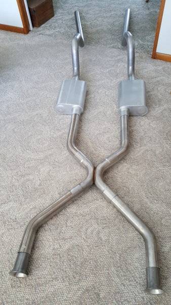

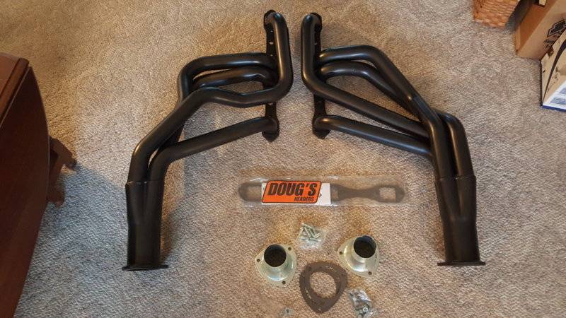

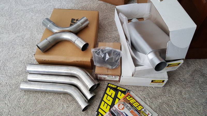

The 2,5” TTI exhaust is in order!
I am still working on the engine but once it is back in the car with the headers this bad boy can be bolted on.
I had in mind to open the side pipes and install a layer of stainless mesh with some absorption material to get rid of the drone.
But i also like the sound of these full systems, so a full set installed and call it done!
Thx for the advises given here!
