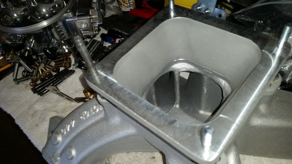

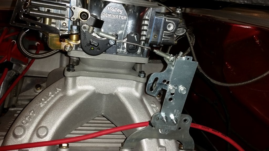

Tom, Here are some pixs. 1 pix is of my TransDapt 4500 to 4150 carb adapter. The other is of my modified/fabricated throttle bracket/cable holder. I used the stock throttle cable AND stock gas peddle with NO modifications at all. I merely went to the hardware store and in the Lumber Department bought a SIMPSON lumber construction bracket and used it to space "up" my stock cable bracket. I had to do lots of "re-do's" to get it "right" but it is rock solid and works perfect.

Thanks Mike. My set up is very similar. I used the Moroso 2" adapter & I have the same intake bracket. I have also been going the hardware route.
My cable wont reach as high as yours. It will barely reach The bracket. My cable is 18.75". I tried a longer cable 25" and its too long, I see Mancini has a 21.25 so maybe that will be the ticket.
