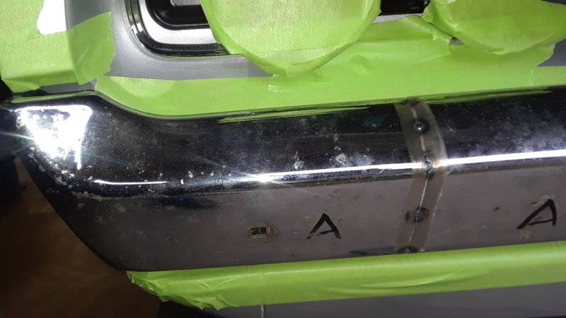

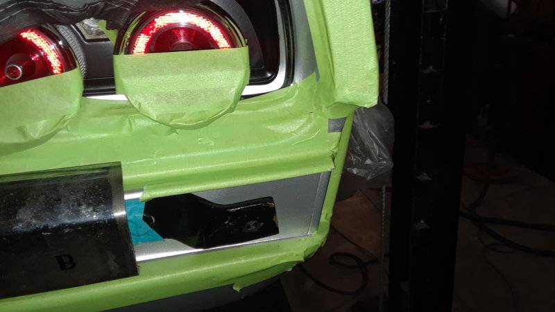

well bumpers are cut and rewelded took pretty much 3/8" off of each side both front and back. it does look quite better they lay in the contours of the quarters and fenders don't have a real good shot of those yet but will have my car back this coming weekend. mufflers were a little of a dabockle was waiting for them to come and called summit they responded with an email saying they were 3 weeks out after telling me they were shipping that coming monday which was 2 weeks ago, I called Borla direct they confirmed that they were a few weeks out and that they just received word about the warrranty from summit that day, in other words according to them summitt never contacted them prior to my inquirery of where are they? mean while my car is disassembled at a buisness taking up space. So I told borla the story and asked them if they had any other similar mufflers and they did, the reviews were that they were good performance muffler and reasonable sound, they are the pro xs model so hopefully there a little closer to what I wanted. the s type sounded mean as hell but when i opened my cut outs there wasnt a whole lot of difference which kinda defeated there purpose, and have a quieter ride and loud when I want it that way.
That's some sweet work on the bumpers! Too bad about the bad muffler. I had a Jegs seamed muffler blow up on me which took a couple years off my life lol. Glad your's didn't fail like mine did. :)

thanks, just taking my time and talking to the right people sure helps alot, **** happens with parts, it was resolved quickly when I spoke to the right person, Borla are great people to deal with.

Great work on the bumpers, as always.

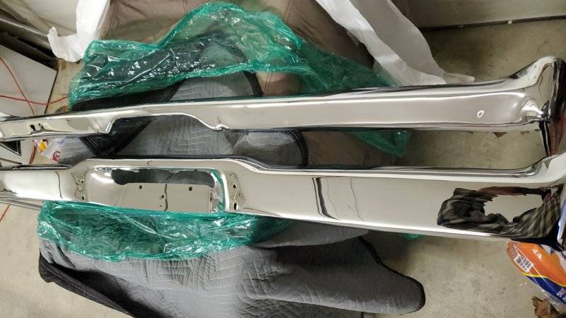

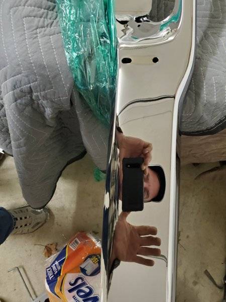

well just picked up my bumpers today, very happy with the outcome going to get the fit a little closer to the car by manipulating the brackets a little, then paint the back with black sem undercoating. getting close with this almost done. gonna hit it hard for the next few weeks will take some more pics th
is week on the rest of the progress.
thank you, cut 3/8" off each side also alot of work but quite a difference in fit into the quarters bumper indentions
