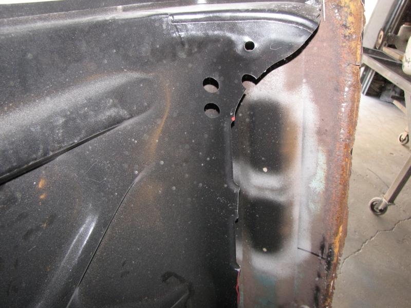

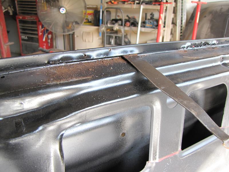

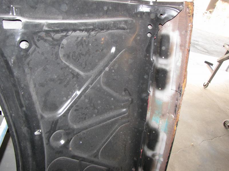

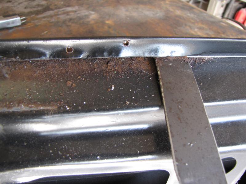

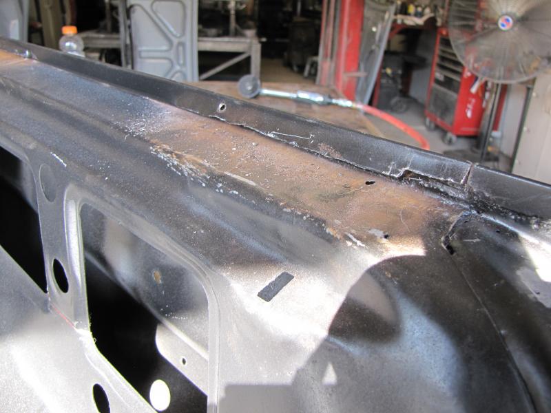

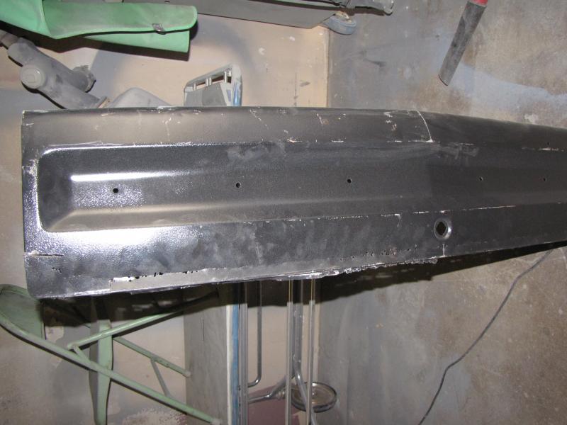

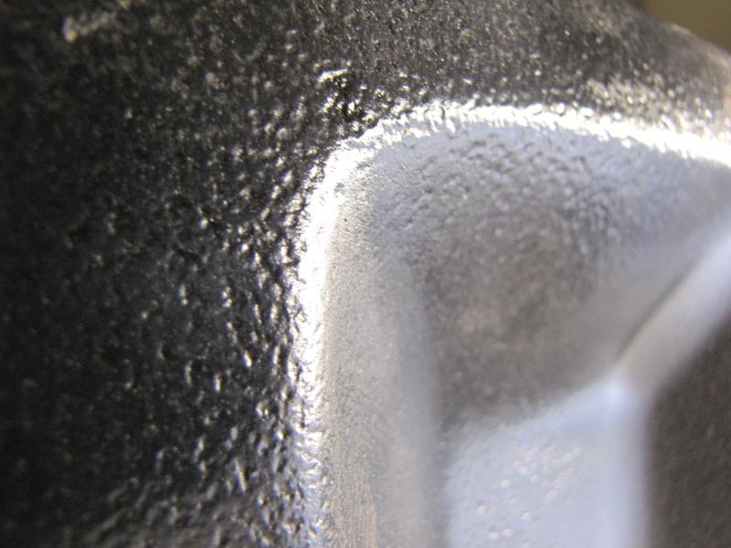

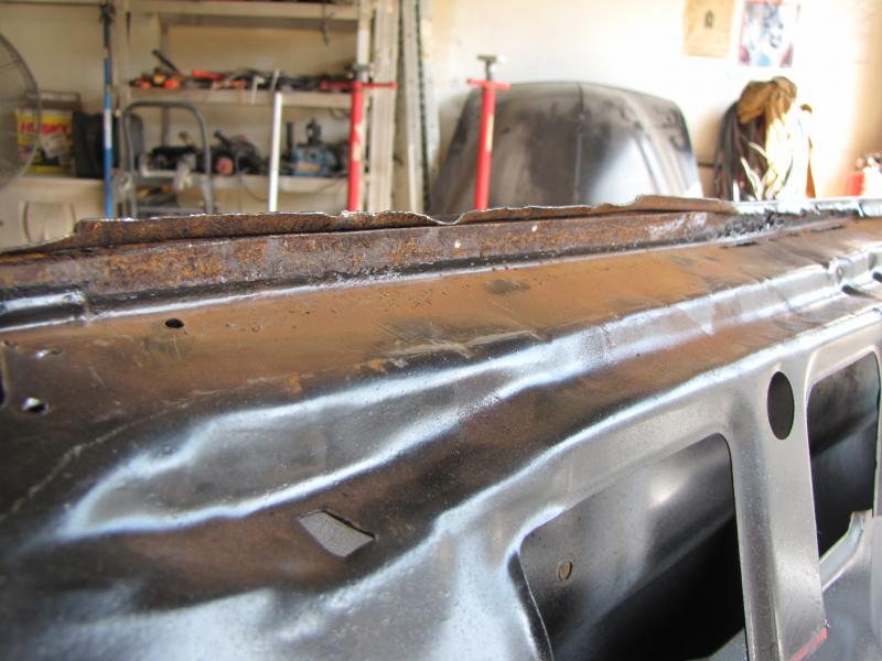

I missed your post Conv67! Sorry! Here's the GTX Deck Lid. I fit it in and blasted it as I worked on paying jobs. Man, the rust pits on this Deck lid are bad! However, I got all the rust gone. Had to remove the inside lower lip though as this is where all the rot is on these cars' deck lids. I took it apart just like on my Satellite deck lid, same game, same process. I will blast the newly exposed inside areas on the GTX lid, epoxy that area, and use 3M Panel Bond to fill in the many cheese grate holes, or, I may just get some new steel and weld it in for strength and appearance. Here's the pics...

On the Deck lid, I blasted the inside section of the Deck lid -- a lot of work for just one piece of the car, but, no one repops these Deck lids, and, nothing is as good as the original pieces. If you can afford the time, or costs to recondition something -- and it's worth it like these deck lids are.
