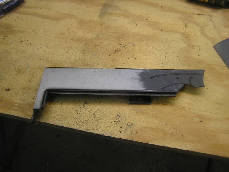

Here is a pic of the pass side bucket and where it broke

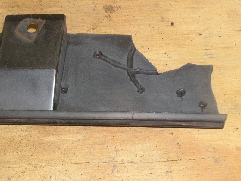

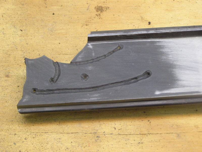

So my plan was to prep all of the plastic pieces (I used a dremel to 45 all edges and crack lines. I also drilled a hole at the end of the crack. This will stop the crack from continuing) and then to create a slurry using ABS shavings and acetone. Then using the slurry to fill in all of the cracks and holes.

I had some problems with the ABS slurry not sticking to the original plastic.

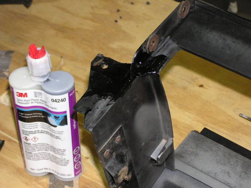

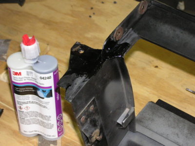

So I started using 3m semi rigid plastic repair
I started with the easy spots first
And gradually worked up to the harder joints

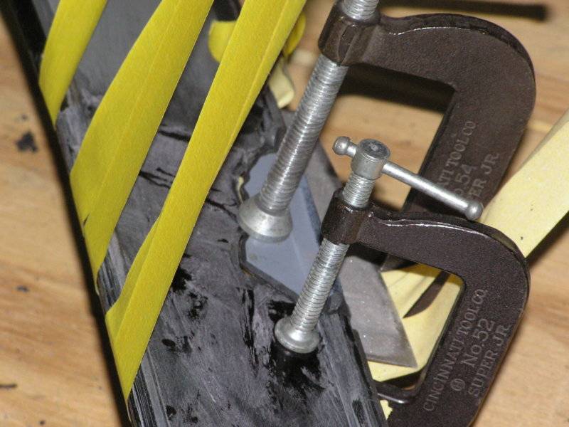

This was a tough one.

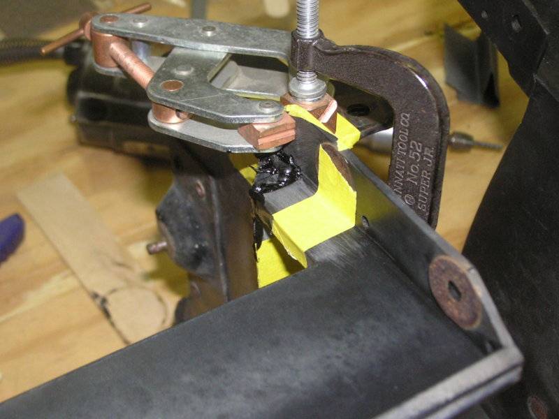

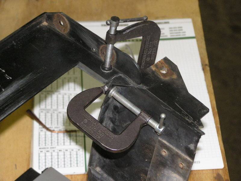

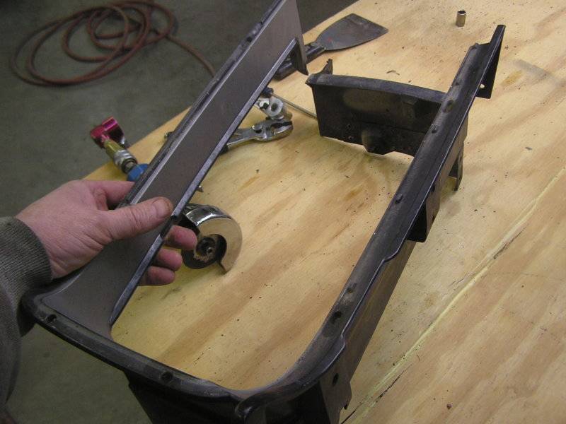

2 joints at the same time. I used small pieces of sheet metal for "backers" to help locate the common surface. Down in that corner I bent a piece of sheet metal into a 90 then clamped it.
view from the back
So what I did was I used wax paper between the grill and the sheet metal backer. (This way the 3m plastic repair wont stick to the metal. Or I hoped it would not stick!) I un-clamped one side and gently opened the gap then applied the 3m plastic repair, then closed the gap back up and re-clamped it.
So after the 3m filler dried, I removed the clamps and metal backer, and then applied the filler to the other side of the joint (where it was previously covered by the metal backer)

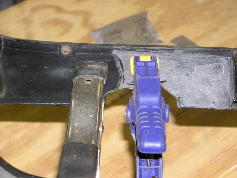

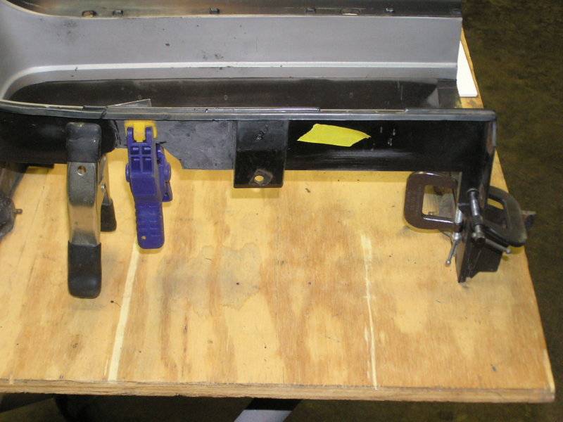

Here is a pic after I rough sanded the joint (the clamps are there for the next step)

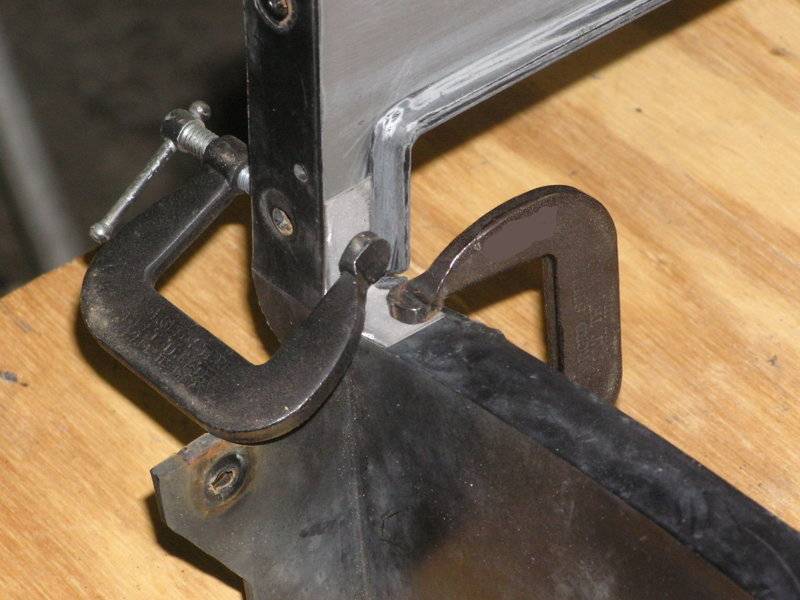

To hold the metal backer for the next piece

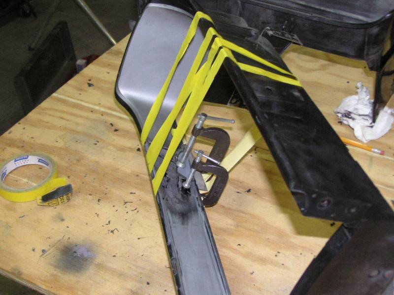

I was having a little bit of warping so I put a little english on it by tapping it up
Here you can see the missing piece I salvaged from a broken up grill I had

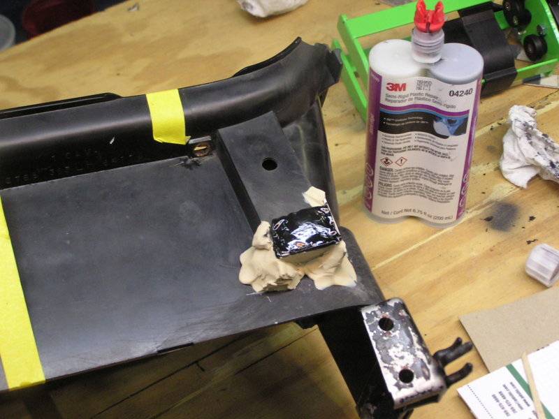

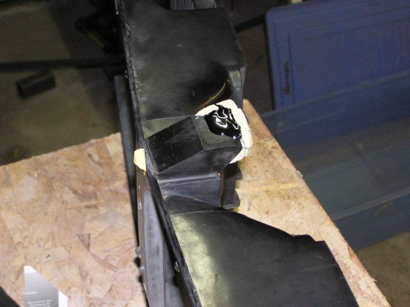

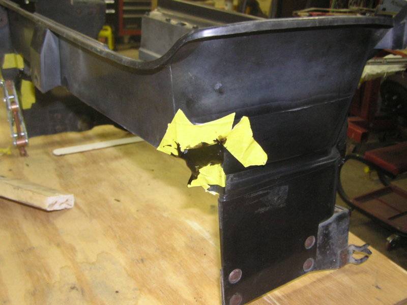

The next area was the broken mounting brackets. One on the center section, and one of the buckets.
I used modeling clay to form the area to repair.
Here is the mount on the bucket
Then fill em up
