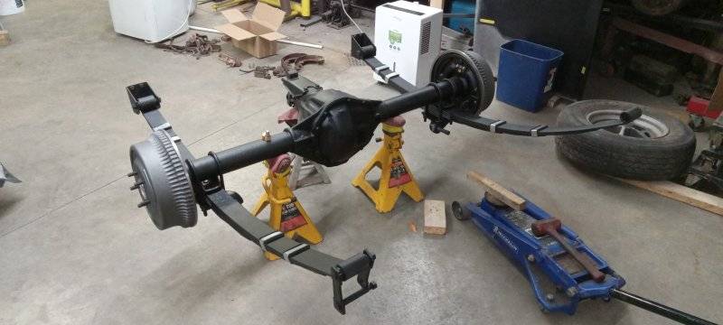

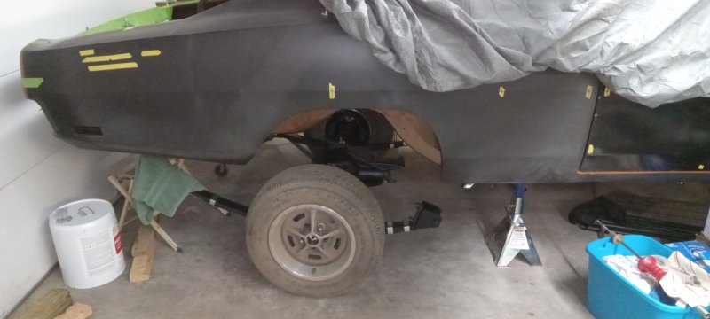

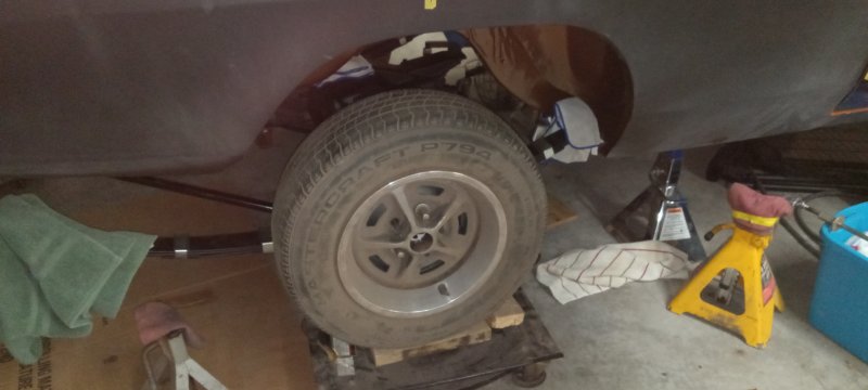

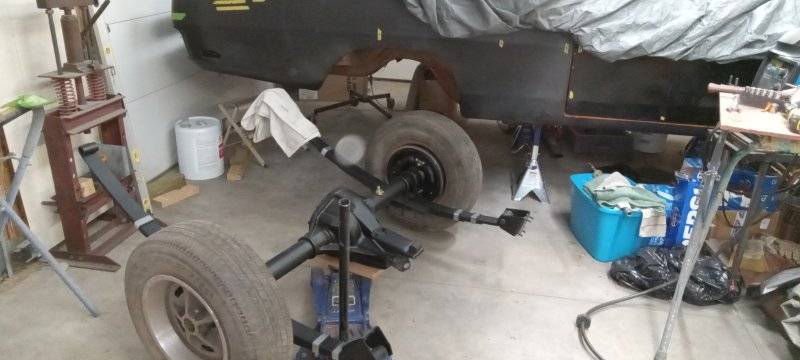

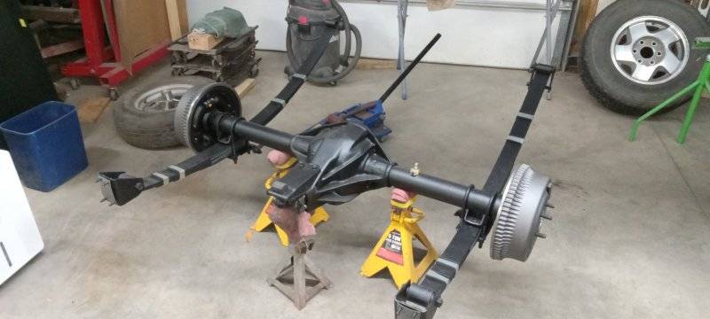

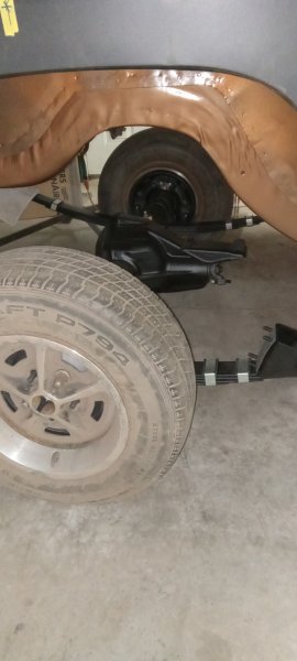

I got the dana 60 in the car
** NOTE TO SELF **
Next time mounting a rear end in the car make sure after finishing you put jack stands under the axel!!
This almost ended badly as everything was ok until I was leaning on the rear of the car and I felt the car beginning to do a wheelie!
(Thank you Lord) Everything was ok, as it barley lifted.
Needless to say I quickly relocated the jack stands!
Nice! I did the same thing a long time ago with the weight too light on a project.
Grate rear end. Put forward with new 6 leaf and 2 1/2 inch recurve on my leaf spring. USA springs. Thought they might be too stiff, but they work grate. This keept me from trying to use Air shocks and shackles to get that late 69-70 rear Gant. Have fun with the project. :thumbsup:

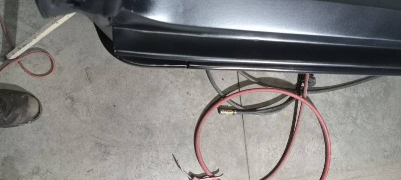

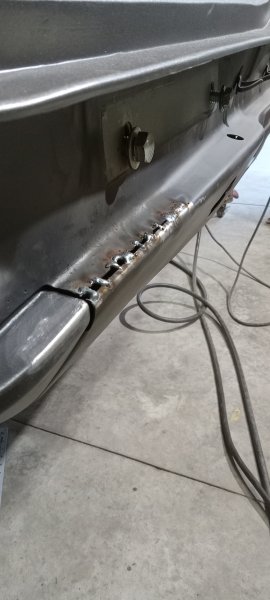

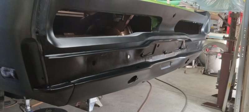

So the next thing I did was straighten out the rear valance and corners.
Before
Fixing the left side
and the right side
All done. It looks a lot better.
Before
and the right side
bravo......... I never hesitate to do a little dice and slice, but it's supposed to be a secret

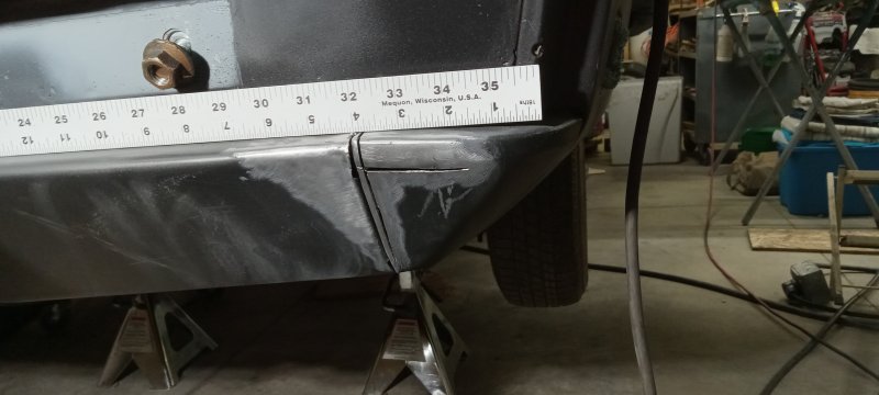

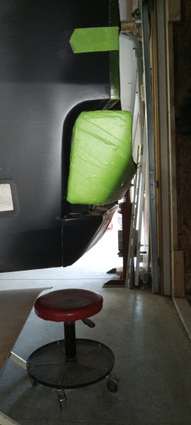

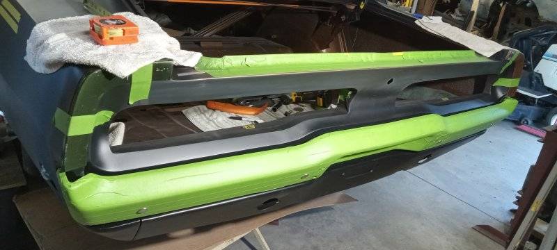

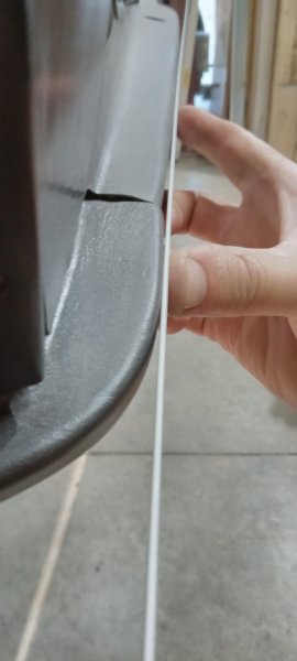

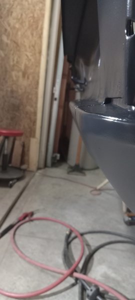

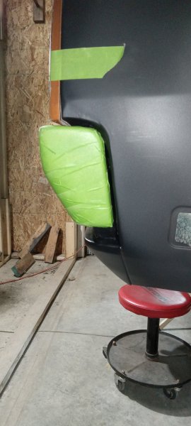

Next up, fitting the bumper.
So after bolting it in, its a little off!
To high. It needs to come down
And it's not clocked right. The top needs to rotate inward

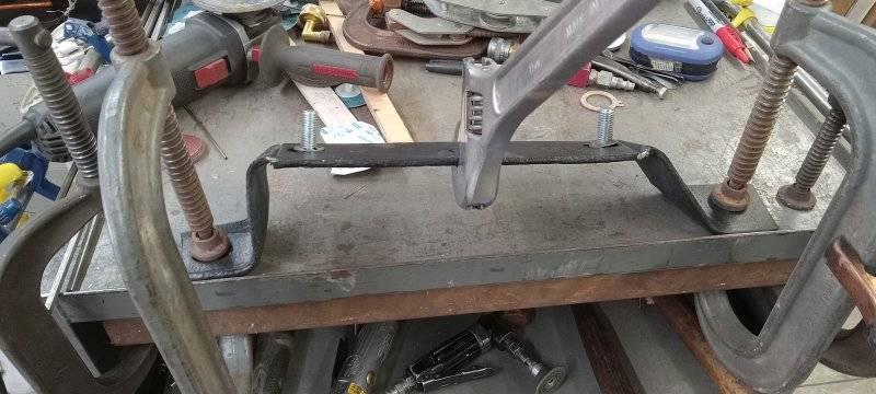

So this is how I decided to get it clocked. I modified the bumper brackets by slicing the ends and bending it down then tacking
This is the result

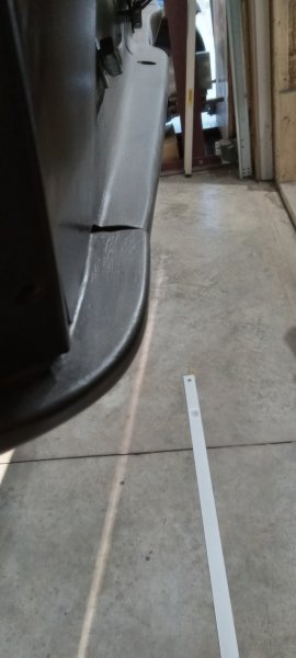

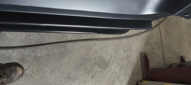

The drivers side need a little more rotation.
And the entire bumper needs to drop
Is there a better way to do this?

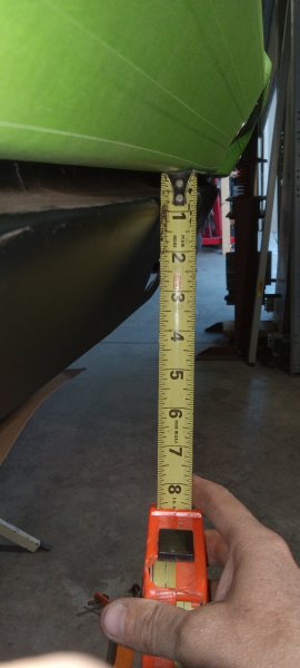

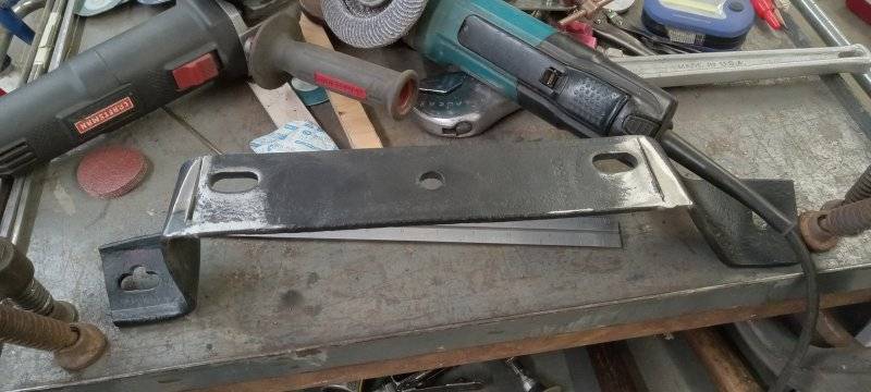

This is the result

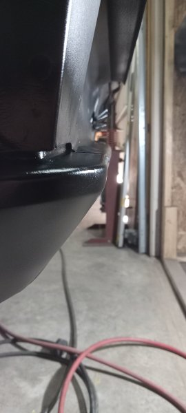

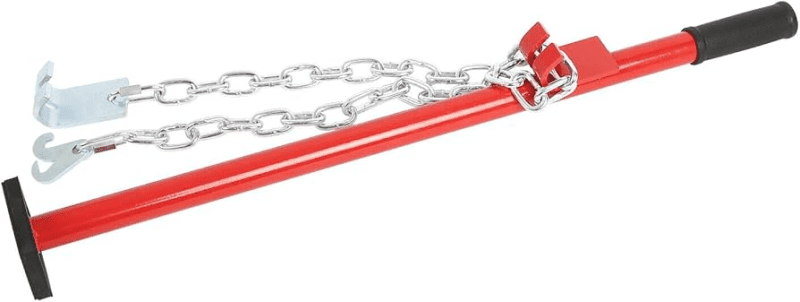

We used something like this back in my bodyshop days to align steel bumpers.
