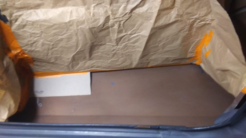

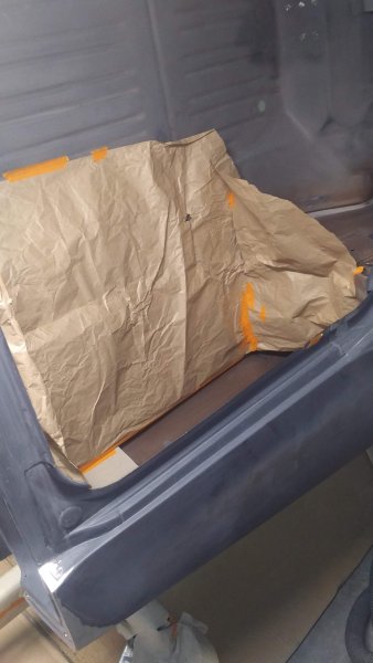

It worked out well for a temporary booth. You do need to be careful with it as it is VERY thin and will tear easily.
It tore in a couple of spots while setting it up but I just taped it up.

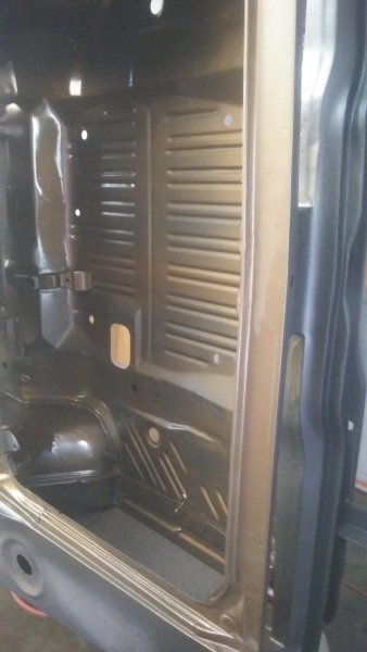

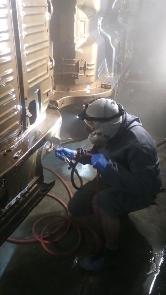

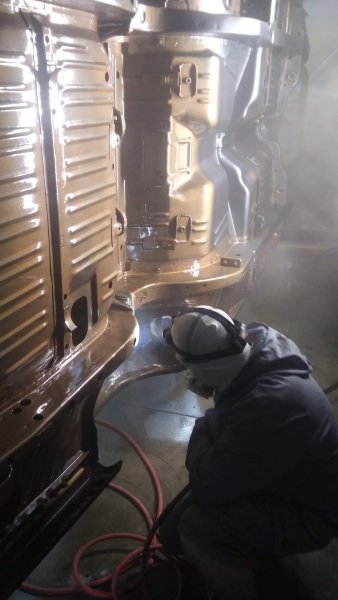

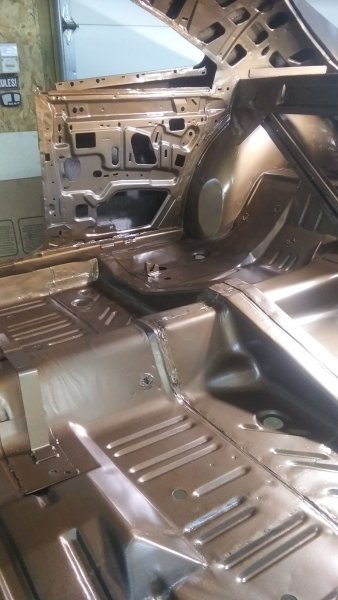

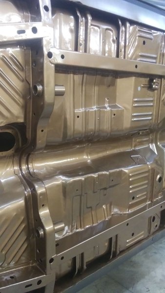

Getting ready to paint, but before I do that I wanted to get Resto Ricks undercoating sprayed inside the trunk.
Nice Don! Looks like I'm just falling farther behind you.... Isn't the sound deading material supposed to be painted over in the trunk? The untouched cars I've seen have had paint over the sound deading stuff.
Hi Sarge. Your not behind, I am the one chasing you.
I still have final gaps and metal work to complete before body work begins.
So the picture showing the sound deadening in the trunk IS after it was painted. I think the undercoating material absorbed the paint that's why it looks like it was not painted. I may have to give that area a couple more coats.

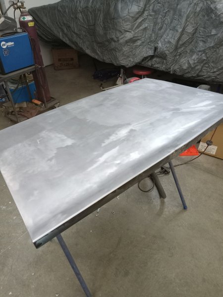

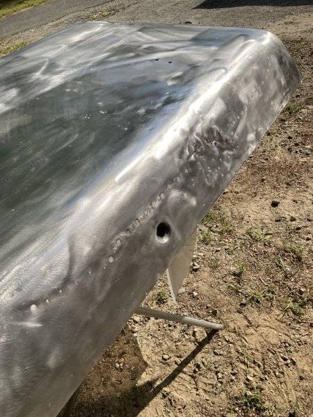

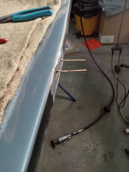

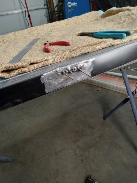

My deck lid needs some more attention, so I used a stud gun and pulled out a dent.
These 3 pics are what I have showing the process
So next I wanted to strip it to be sure there were no surprises!
I used a heat gun and putty knife to get the majority of the filler.
Then followed that with a wire wheel.
Overall its good. It just had a lot of filler
Here are a couple more pics showing the dented area
Good job. It looked like someone had danced on my trunk lid. Also, someone had punched out the lock to get access it looked like. Took a lot of work to get everything out. Grate job keep up the good work. :thumbsup:
Nice! Great to see an update. Here’s what was hiding under bondo on my trunk lid:

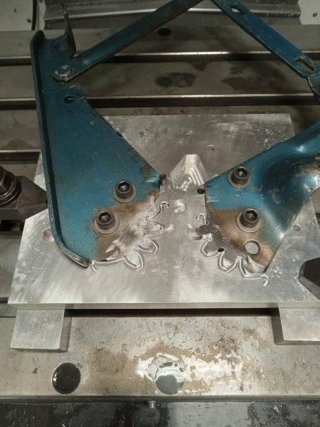

So I decided to fix these. And this blue hinge would be the test subject.
I had to do a LOT and I mean a LOT of research to come up with the right gear tooth shape.

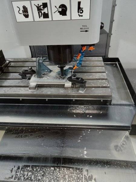

Once I had the shape I drew it up in CAD/CAM then machined it into acrylic and tested it. NICE and SMOOTH!
So next I welded up the teeth, and made a fixture, then machined the new teeth.
A friend made up some new rivets and after machining the pivot holes I put it together and it worked perfectly!
NICE and SMOOTH!
So since it all worked I went ahead and picked a set of hinges. Machined new pivot holes for all the joints and welded up and machined new teeth epoxy primed everything and installed the rivets. I am happy to report that they work flawlessly on the car! And yes, when I close the hood, it truly closes all the way!

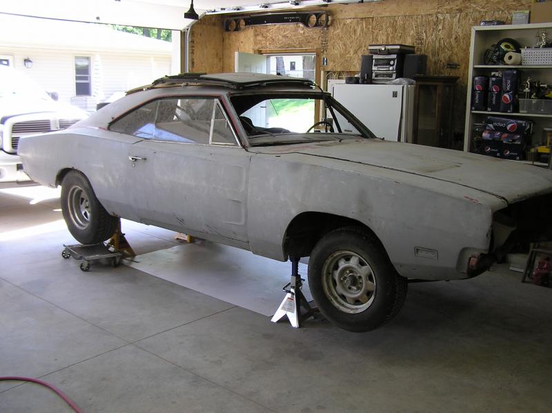

This is what I started with

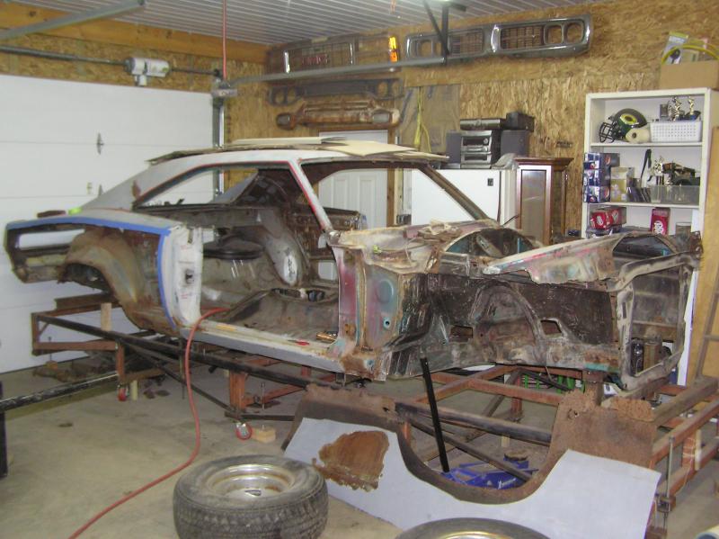

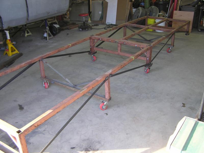

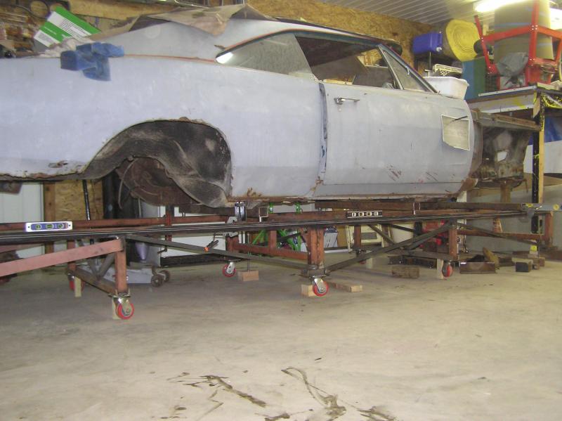

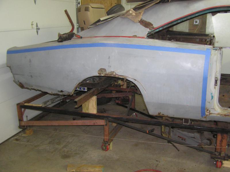

So I built a body jig to hold the car securely during disassembly.
The jig was originally a 4’x8’ table that I picked up at the local scrap yard. It was cut in half horizontally then put end to end to give me 4’x16’
It‘s made from 2x2 tubing with ¼ wall. And has leveling screws at every leg.

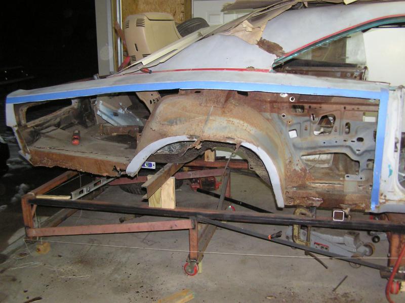

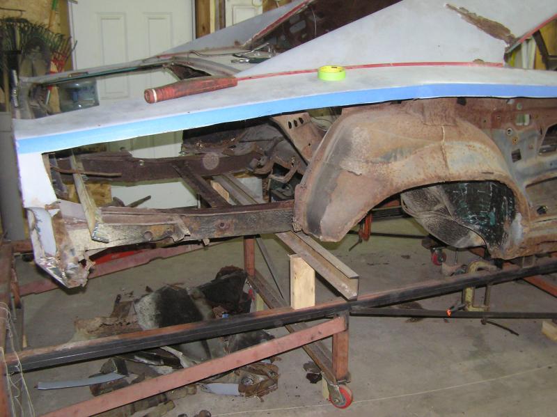

I cut the quarter panels off to get better access

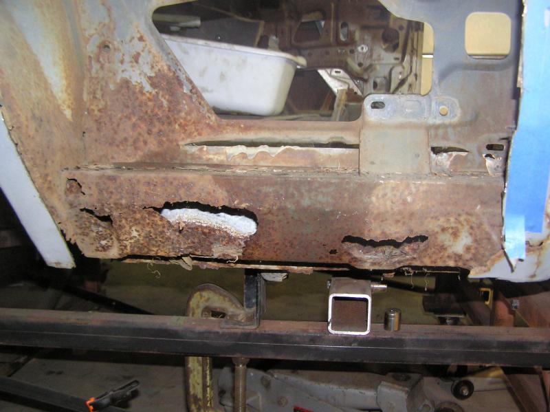

Outer rockers are shot!

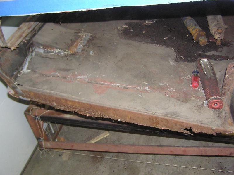

Trunk pan was patched long ago and will be replaced
So out it came!

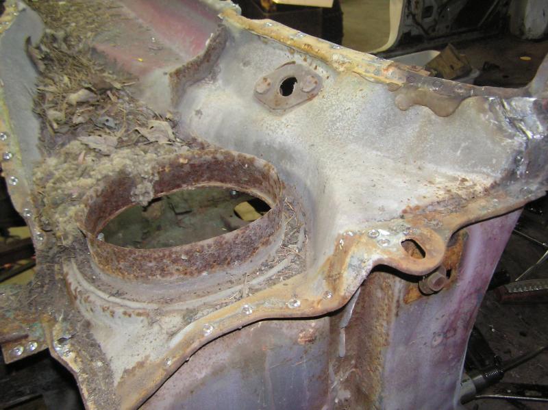

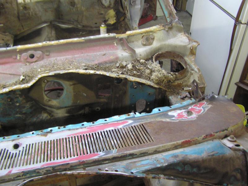

Next, time to remove the cowl
Lots of pine needles and a mouse house

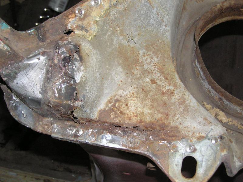

Rust damage around the base of the a-pillar, this will be fun to fix!
A diamond in the rough? I can only hope!
Any and all comments are welcome!
