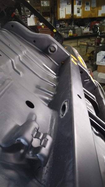

I have the drivers side torq boxes in
Not the best looking welds but I will clean them up a bit......

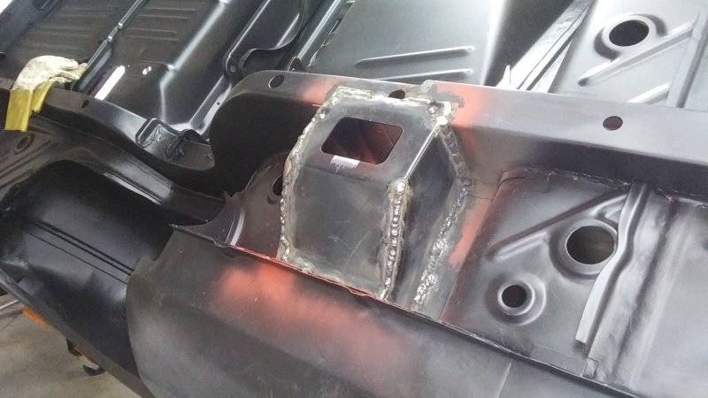

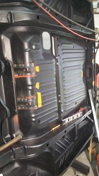

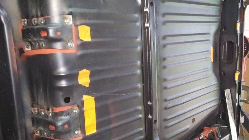

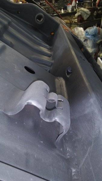

So here are the gas tank brackets welded in

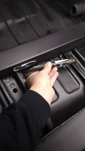

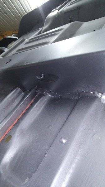

And layout and fitting a piece of 1/2 black pipe for the e-brake cable pass thru tube.
So after I welded the black pipe in I inserted a piece of plastic pex (had to sand it to make it slide in) I did this to prevent the cable from rubbing metal on metal.

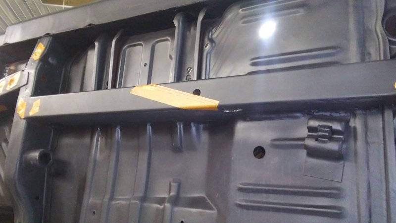

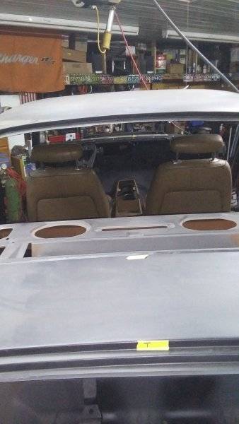

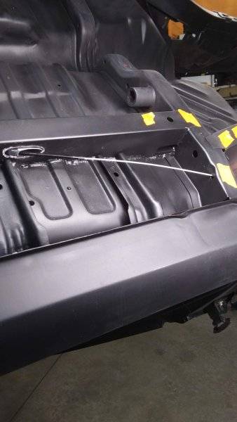

I got the rear package tray cross member supports welded back in

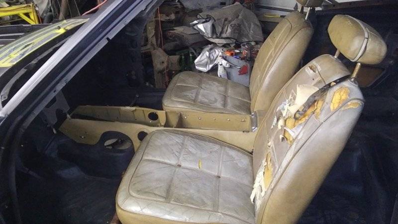

The next thing I did was figure out where the console brackets needed to go
I used this pic I found to start off.
Had to modify my automatic console by cutting out for the floor hump.
I used this template I purchased a few years back
So I had to mount the console brackets to the console then I put the seats in and checked the position of the console between the seats
Had a little help from my friends with the positioning of the console.

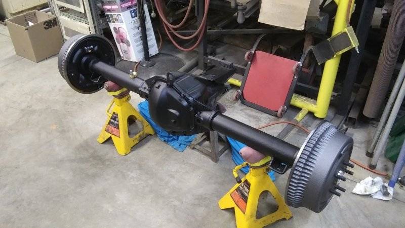

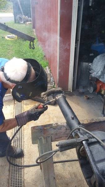

Dana 60 rebuild

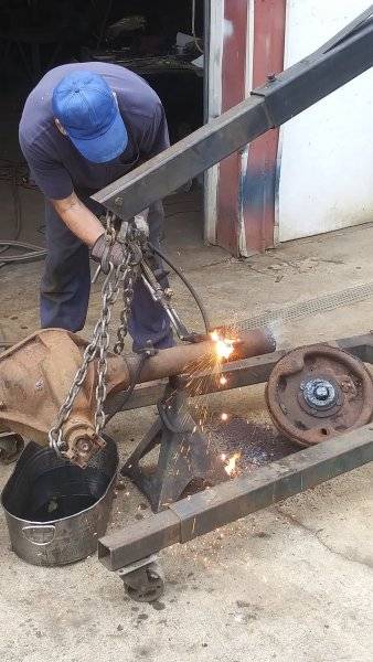

I found a Dana 60 that came out of a 1970 dodge truck and my friend helped me convert it to use in my Charger.
Here is my friend torching off the ends of the axle and spring perches
Here he is mocking up the new axle ends
Welding the ends onto the axle

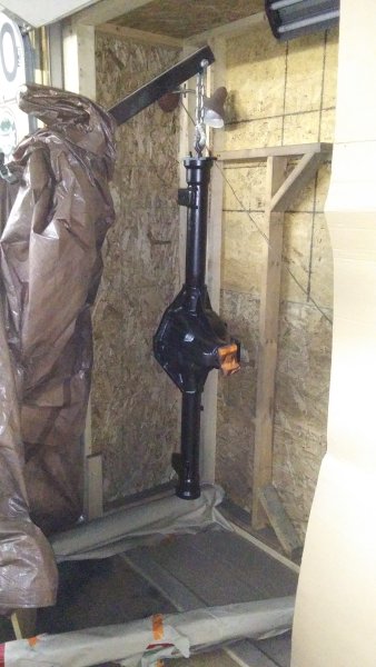

Here it is freshly painted
And as it sits now. READY TO INSTALL!

I went with the 11 inch drums, hope I wont have any problems
Tell us about the alignment bar and pucks.
The alignment bar and pucks keep the ends straight and perpendicular to the center section so the axles will not bind

;-) I think a lot of us know what an alignment bar does. Lol
I meant where did you get the alignment bar and pucks- what was the cost?
Sorry I don't know the cost as the bar and pucks belong to my friend. I believe he had them made.

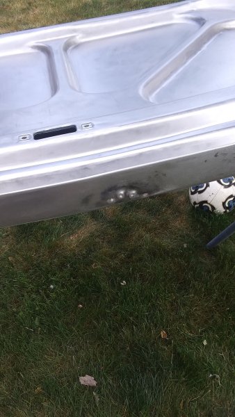

So I have what I think is a really nice trunk. But rather than hope its good then later on it bubble up on me I decided to strip it and make sure there are no surprises!
So here is the before
Well it didn't take long before I found a surprise!
I went ahead and fully stripped the back side
Here is my pup Hemi giving her approval.
Then I sprayed it with epoxy to protect it.
So this will get put to the side until I can fix that dent. But at least I know whats underneath!
