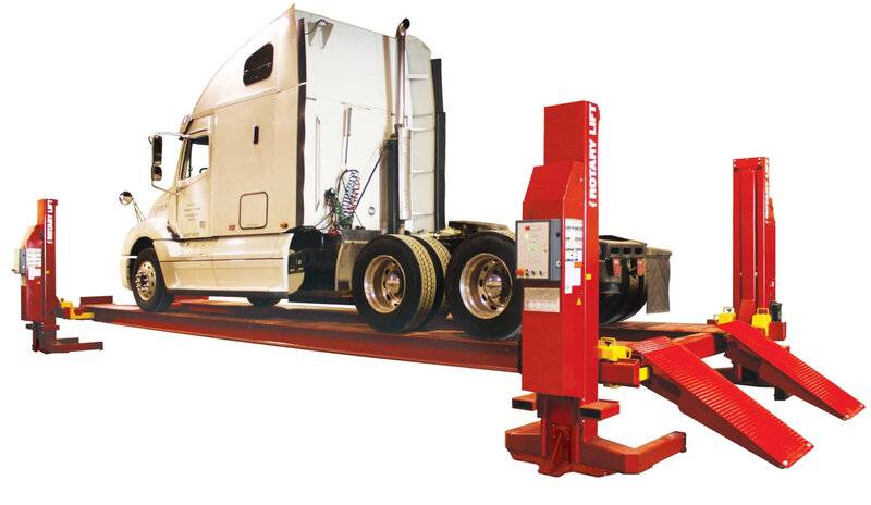

I would like to get one similar to this one...
Is that fully hydraulic or hydraulic with chain lift?
The Rotary that is pictured is fully hydraulic, with each post being independent of the other, yet all work off the same controls. So you can raise the entire lift from any of the 4 posts, or just raise 1, 2 or 3 if you wanted. It has a 60,000 lb capacity and maximum lift height of 78 inches. They also have an optional wheel kit to make the entire lift mobile. Why you would want to move it I am not sure, but it's available. I can't imagine what that must cost but my Kenworth dealer has one and it's nice.
I can understand the mobile wheel kit. I have a son that owns a truck shop and truck line in Phoenix. Will have to see how mobile they consider mobile is. Lots of difference in across the shop, parking lot or road worthy.
Not sure I would consider taking it to a job site though or trying to lift a tractor for road repairs.

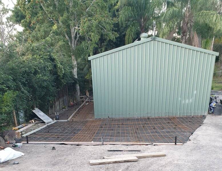

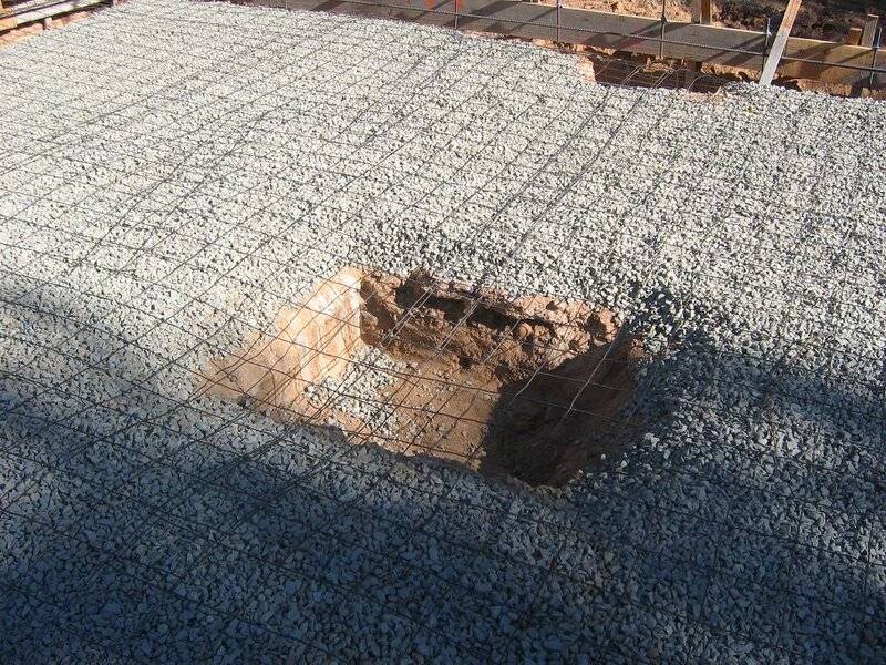

Looks good thickness wise, but without trying to be critical, and in case anyone else pours their own slab and looks here for advice, go much heavier on the mesh reinforcement, and drop a reinforcement cage in each thickening for the post locations. This photo is just a slab to park a car on but you can see how heavy the reinforcement is (4" thick slab).

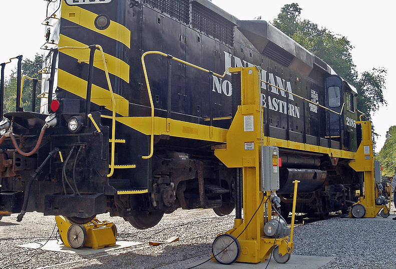

On the railroad, we had some nice portable electric screw jacks, made by Whiting. You could get them up to the 60 ton range (each). They were connected together so that a single person could operate them all at once. (not my photo) They had wheels but at over two tons per jack, still a struggle to pull them around the shop. Those wheels are not taking any load right now, they retract when the jack starts to lift.
What does an engine like that weigh?
