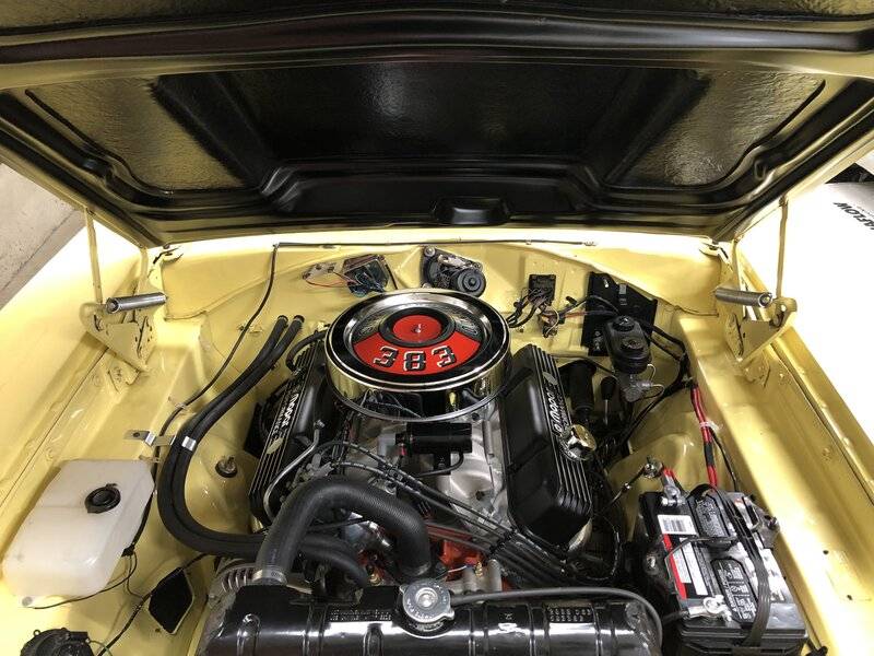

Interesting thread. I have been following the switchover to EFI or new engine/driveline swaps for a while. It has largely been black or white from most peoples perspective but I think it is getting a little grayer as people see more of the new transplants working. There also is a larger availability of modern tech at less than brand new prices (i.e. Junkyard offerings). The way I see it, you can upgrade to all new tech and get the advantages, but you also get the downfalls of doing so (harder to diagnose issues and a greater dependency on tools most don't have access to). Or you can stay with old tech and deal with new problem we see largely from new gas or poorly set up electrical systems. If you don't make sure you have great electrical and clean power your MSD boxes, ECU's etc are going to keep failing you. New cars have this figured out so they don't have these issues anywhere near as much. Most of the drivability issues people have with the old tech have to do with a fuels system not set up to deal with new gas. If you run a return line system with an in-tank pump and insulate your gas lines in the right places, you can start up a carbed car and drive it wherever and whenever you want. I live in Wisconsin and have a 526" w/ported TrickFlow 270's, a .715 Solid roller ([email protected]) and it will start with 3 pumps every time and idle off on it's own in 30 seconds or less no matter what the temp (started at a lowest of 35 Fahrenheit so far). Invest in a good AFR meter and tuning it becomes a whole lot easier. If better management of timing is an issue, get a Progressive Ignitions distributor and you can have vacuum advance and fine tune your timing curves to be more inline with modern cars (and switch it in 30 seconds to a drag strip tune). Need an overdrive, they are out there. My Gear Vendor unit let's me drive with 4.30"s on the freeway at 70 mph and still get almost 14mpg. It really isn't about old versus new, it's about using the technologies available that can make old livable for you, or spending a bunch of money to switch over to modern to get the same. If you have to do a major redo, it may make sense to switch to modern as the whole package has already been figured out, but for most of us we can get to a great compromise in baby steps and still have that near modern experience. It all depends on what level of troubleshooting you want to do, how much you want to spend, and how much frustration you can deal with at a time.
