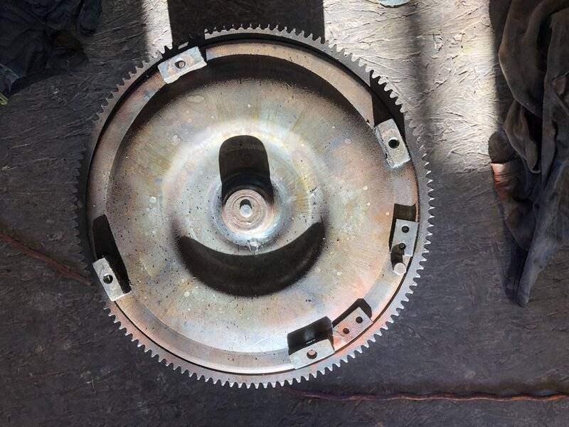

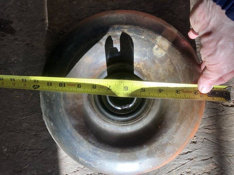

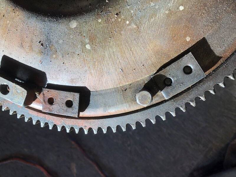

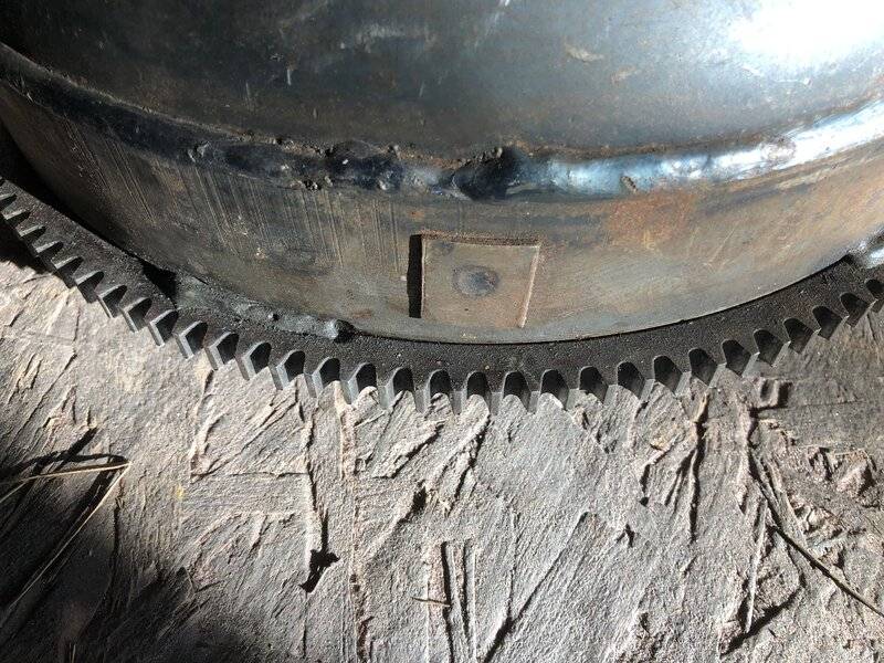

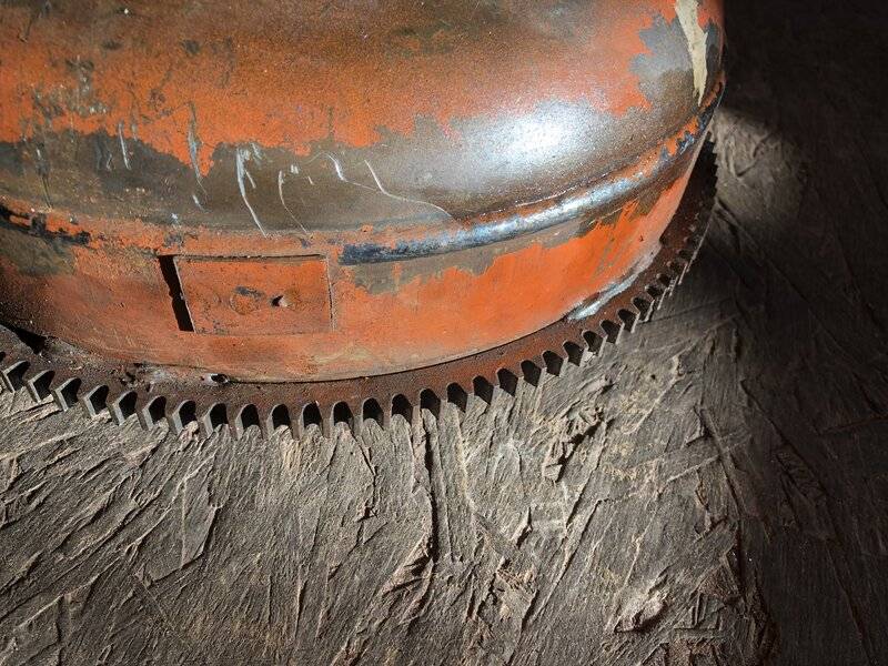

Camera angle is bad in the measurement photo. It is 12"" not including ring gear. I see that mine does have weights, two on face and two spot welded to outside.

I did do some research. The TQ I have is 12" (the photo is a bad angle), and it is weighted/balanced). I have a local guy with a Daaco 10 inch near me. He wants $150, but it has no weights. So, I do not imagine that it will work for me.

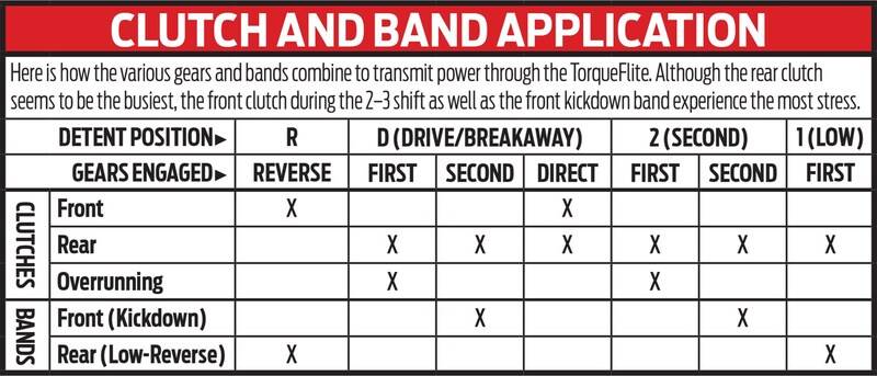

I thought the third gear ran through the front and rear clutch only. There is a low/reverse band, and the 2nd gear kickdown band but no band for third.

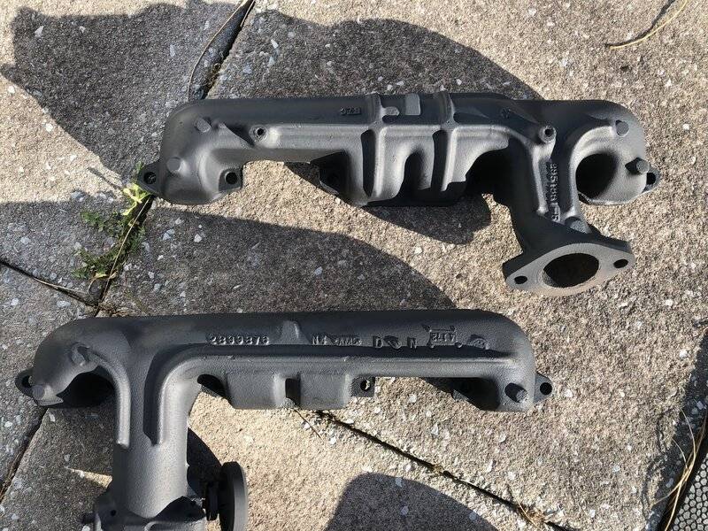

I have all the same issues. I had to remove the headers to remove mini starter and to gain clearance to the transmission. They will NOT be going back on ! I bought some log manifolds that will work much better for access to things like the starter and spark plugs. I just finished sandblasting them yesterday and applied 3 coats of VHT Flameproof ceramic manifold paint. I think they look pretty nice. Cost me a whopping $75 + paint.
You are correct. Bands are for holding things back, and clutches allow reduction during SLIP. In third gear, bands are not applied and clutches are applied, causing the entire planetary train to spin as one unit, 1:1.

Ok, sorry.... So, a new torque converter is not going to bring back third gear. The trans will need overhauled...depending on what is found to have been the cause, you may or may not even need a new converter. If you do, then it will need to have balance weights like the one you show, and you may need a trans shops help with that. Do you know details about your cars drivetrain build?? Meaning, is it all original? Maybe a pic of that front balancer will help us determine. HTH, Lefty71
