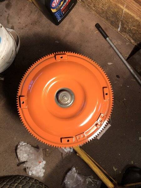

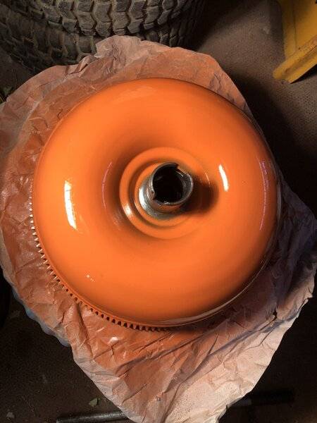

Had a couple of nice days so I cleaned up the Torque Converter and painted it. Finished up my High Heat Engine paint.
