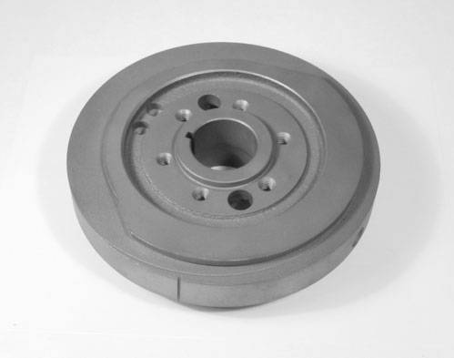

This is the damper I have on my car
damper #3512017,
Courtesy of 440 source.com:
Shown above is damper #3512017, commonly known as a "six-pack" damper. This damper can be easily identified by a small .210" thousandths thick elliptical weight attached to the center hub. This version was used in '70 and '71 and has the offset pulley bolt pattern. Be careful not to confuse it with 3614372, which was used only in '72 and looks similar except for having a symmetrical pulley bolt pattern. The weight on the 3614372 may be slightly thicker at .255", but we have not been able to verify this.
Even though these dampers have an elliptical weight, they were never used with any cast cranks. These dampers were used with steel cranks and "six pack" (2951908 casting #) rods. The extra weight is to offset the added weight of the extra metal in the rods and pistons. Another important fact is that even though six pack rods continued to be used up until 1975 in HP and truck 440's with steel cranks, they did NOT use this damper. As you can see from the chart above, any 73-75 steel crank 440 (with either six pack or standard rods) would have come with the 3614371 damper. We have found this to be absolutely true.

Right!! So, if that's the case, that's no cast crank motor. If your converter is original to the car, then that weight setup should be duplicated exactly, I do believe. If it's not original, then we need to solve the mystery of what to use. Maybe some folks who have had six-pack original and magnum-440's with six pack rods will chime in.

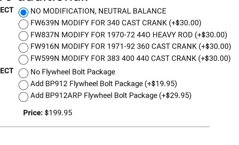

You have a unique torque convertor for the heavy 6 pack rods. I am sure somebody out there can do a convertor with the right weights but I don't know of anything over the affordable counter.
This is a list for flywheel balance weight options for a manual transmission. Automatics would share the same balancing. My suggestion.. Do your best to reuse your convertor...its your best option. Neutral balanced will vibrate and cast crank convertor is similar but not correct.:(once upon a time they made a flex plate to overcome it...but I think it's been discontinued..and it would add to your cost

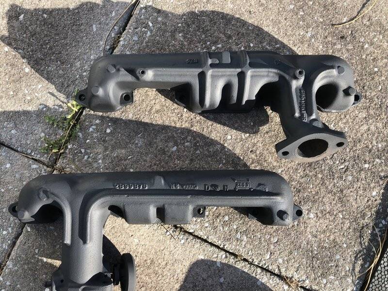

I have all the same issues. I had to remove the headers to remove mini starter and to gain clearance to the transmission. They will NOT be going back on ! I bought some log manifolds that will work much better for access to things like the starter and spark plugs. I just finished sandblasting them yesterday and applied 3 coats of VHT Flameproof ceramic manifold paint. I think they look pretty nice. Cost me a whopping $75 + paint.
Look at that, I hijacked my own thread !
LOL! Believe it or not, had a 71 340 Cuda with the Hooker Super Comps on it and the factory style 'short' starter would come out without unbolting the header but had to hold my mouth just right and stick my elbow up my butt to do it lol. There was only one way that it would come out and it was snug doing it.

Had a 70 Challenger 440 RT that had the same balancer but never had the trans out so can't add any info on the converter weights if any. Did the car vibrate any at all in neutral sitting still and bringing up the rpm? If it was out of balance, you would feel it well before 3500 rpm.
