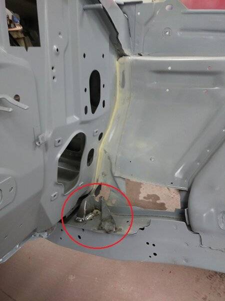

I think driveshaft is different length.
steering column for 67 is 67 only
your gonna need one of these 68-70 .........I assume 67 is the same
