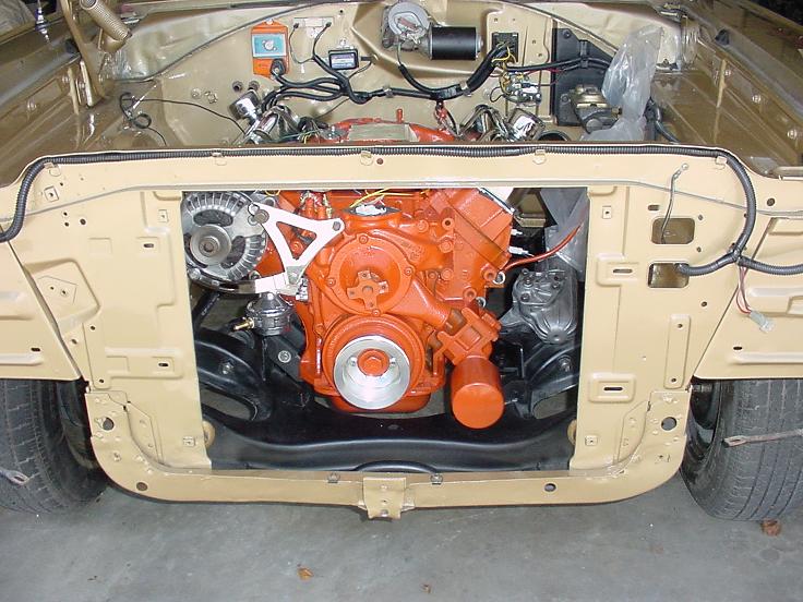

OK two and a half hours and its in. A little persuading with a 2x4 and 5# hammer to line up the motor mount holes but its in. after its all hooked up with the cast iron manifolds it will be broken in and then have to lift the motor again to put in the ceramic coated headers.
All useful tools!!
Yep, looks like everything is where it should be.

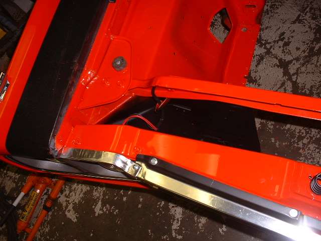

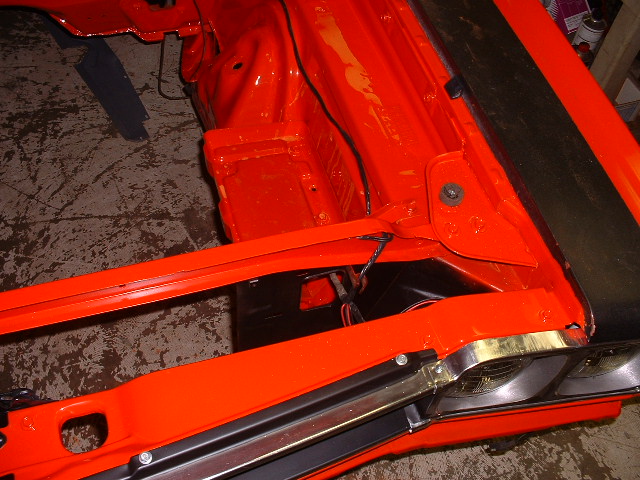

Don't forget to black out the front of the rad support before you put the grille on. In case you're not sure this is typical of how it should look.
