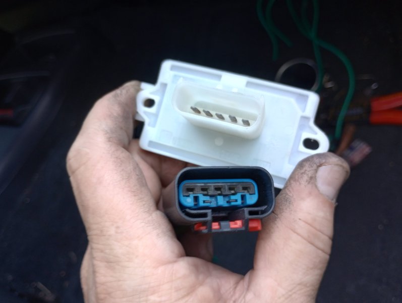

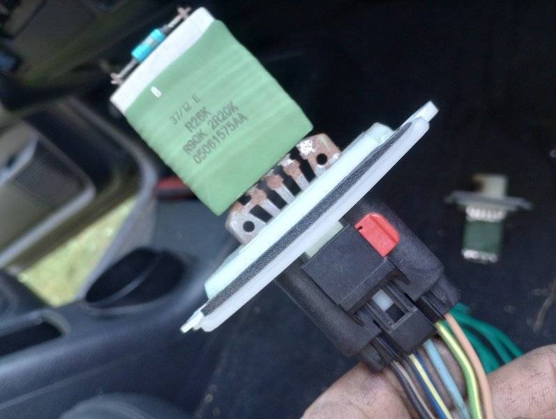

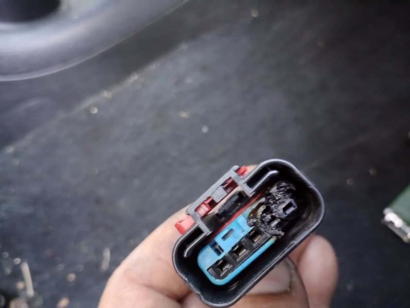

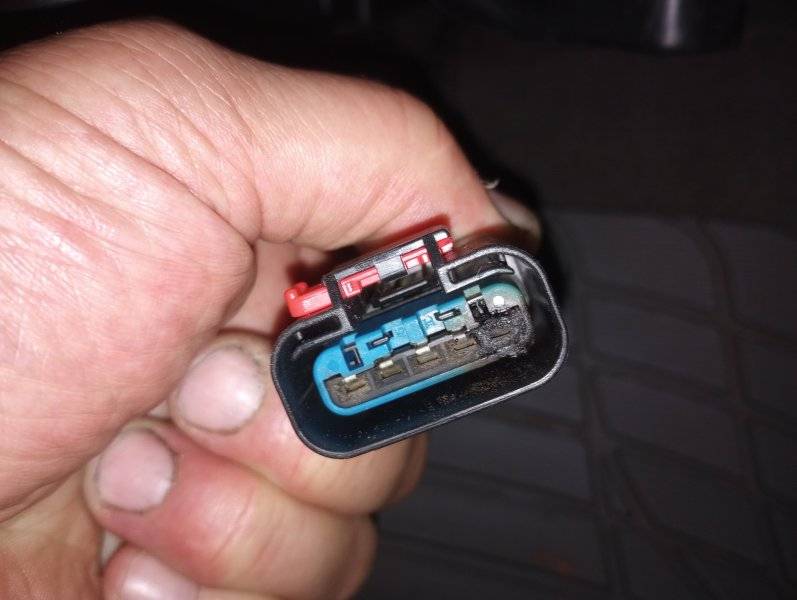

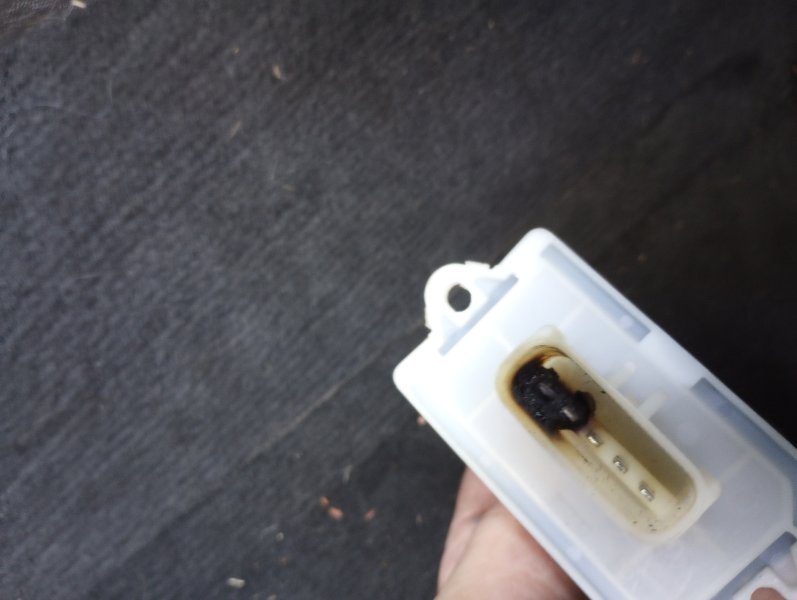

anyway, I'm out cruising cool and trouble free and all of a sudden the entire A/C system shuts off; fan, a/c light, all of it, like I blew a fuse. :wtf:
so I cut the switches off and head home to investigate..........
I headed straight to the blower motor, not sure why......... but I immediately notice someone has been here before, looks like a replacement plug and a pigtail........ and it's burnt. The wire on the end is ground, it was also heated further up the line where the splice was done.

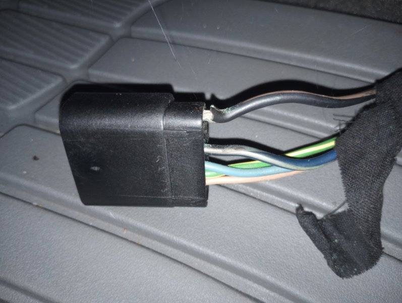

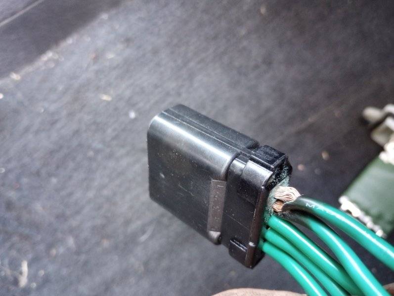

so I head out to the Durango just to take a look for comparison...... and my original plug was in the process of failing....... ah hah, common problem.

Is the plug on the air box?
I'll be out with mine most of the day tomorrow. I'll definitely give the ac a workout with the heat we've been getting. Won't hurt to check it out.
right under the blower motor, pass side interior........ in plain site
2 8mm screws will remove the resistor if the plug is stuck, mine was
use a mirror, makes life easier
