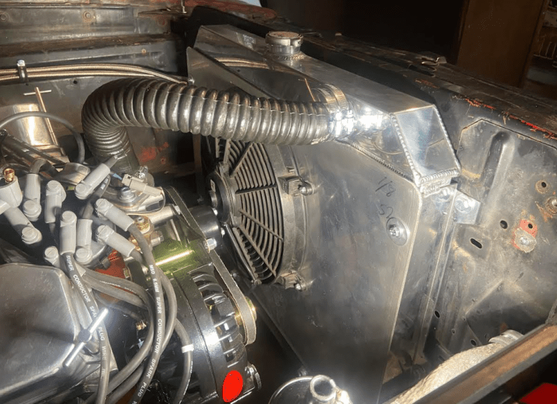

What I got. 68 Charger. 383 with a Champion 26'' economy two row radiator. Electric fan. Finally just got her going and off jack stands.
My situation. She seems to flutter at 200-210 after initial drives. Maybe it's just the racer in me but I just hate heat over 200. I haven't even begun to push the car and worry it's not going to like it when I do if regular driving is reaching 210. It'll be a Street/Strip car that'll see extensive usage when it's 90+ degrees out.
I plan on drilling holes through the shroud to allow for more air flow and I do know ceramic coat on the headers would probably help some but that's about all I can think of. Should I be looking at a second fan for 26'' radiators? Hood scoop to vent more heat? I know this is a never-ending battle that we never really win but wanna exhaust all possiblities and tricks.
I honestly can't believe that setup doesn't get even hotter than 210....
Has the motor been broken in yet (assuming fresh build)? It'll run hotter for a while. Pro & con on electric fans with folks having their opinions - pro & con. This topic has been discussed a whole bunch on the forum. Suggest checking some of them - tons of helpful tips.
Lots of things go into the overall cooling performance but yeah...you need more fan and a better shroud. Look into a dual-fan/shroud setup if you're sticking with electrics, there are quite few options out there.
By the looks of that photo
It needs room between the shroud & radiator too
it looks like that shroud (flat) is right against the rad (or near)
no room for any airflow, in the area to the right of the fan
essentially only has 'any airflow' thru the radiator &
only at the point of the 1) 16" (size, I assume) round fan opening
you need more air movement everywhere, even with just the 1 fan
The shroud needs to be a lil' bit away from the core,
or at least tapered directing air away from it
& have some standoff
& have room for the air to move away from that part of the radiator
if that makes any sense
good luck
Agree, that's not a shroud it's a 65% block off plate.
I run the same fan, but none of the rest blocked off.
And those water wetters do work.
Good to note. I knew it needed tinkering but maybe far more than I originally thought. Thanks y'all. Will mess around with it more.
Agree that's not a shroud.
I would get rid of the plate and try some large zip ties to hold the fan on the radiator.
I think it will improve the situation.

It may also be a plus to move the fan to the
passenger side (under the filler neck)That
shroud is blocking off a lot of airflow. It
needs a smooth transformation from the
radiator mounting surface to the fan opening.
The fan should be approx 1" from the radiator with the fan blades into the
shroud about half way with 1" clearance
around the fan.
About 1/5 of the rad core is not covered
by the shroud.
My 440 is not broken in yet, and reaches
temps of 210 idling. A short trip around the
block brings the temp down to 200. This
will drop some once the motor is broke in.
The fan is 3000 cfm on a 3 core aluminum.
[1] Remove toy fan
[2] Fit factory shroud & clutch fan
[3] Go out & celebrate...
