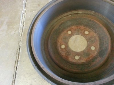

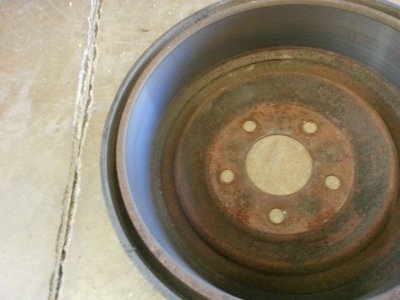

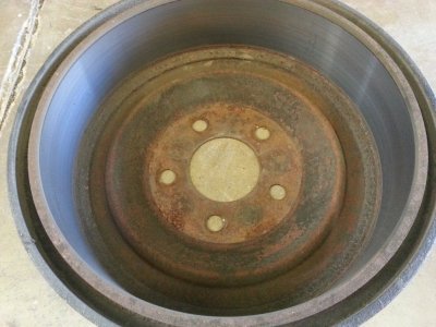

Some drum pics. I assume they look okay, but the fronts were better.

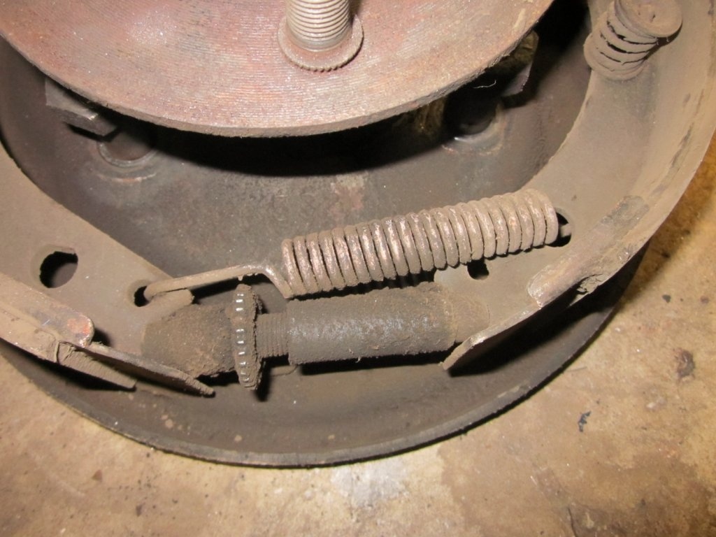

I'm talking about 'end' of hook on springs. Oughta be parallel to body of spring, then you know they won't pop off. Probably never happens, BUT??
Besides being dirty, they look to be in good condition. Rears don't get wore down at the same rate as the front so they last much better. Wheel cylinders are replacements but no leaks is always good. Adjust and run!
I did a quick Brake Kleen and adjusted. Might replace the rubber brake hose while on jack stands.
Not bragging, but so far this car has not had any surprises. Still no redneck engineering, of roadkill evidence. I'm happy with my purchase, so far. It's just an honest solid driver.
I second replacing the rubber brake line if it doesn't look pretty new. And also check the axle play while you are at that point - very simple if you have a dial indicator and mag base.
the lower spring doesn't look right and appears to be hitting the adjuster. Might tighten things up on you while your braking?
here's a pic from my 64 with 10" and no self-adjusters for example.
I have had my manual adjust set up with the spring riding on the star wheel to keep it from moving. Always worked fine.
OOPS Didn't think about this reply going to the end. I see others have already commented.
no worries, I was just trying to help. I never had manual adjusters so it looked odd to me. Glad the guys on here pointed out my mistake and the incorrect set up on my own brakes. Always glad to learn from you guys!
