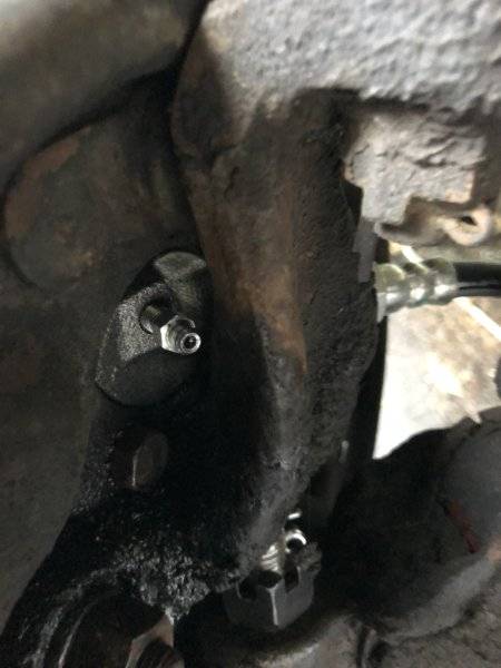

I have to get one of those one way check valve bleeders from Autozone tomorrow. I did read they have bleeder screws with the check valves in them. That’s a great idea! Tough to see here but there isn’t any room to get a wrench on the screws. Only a socket. And it’s 9/32”. The only wrench I have that size is an ignition wrench. Here’s a pic. Again it look like there is plenty of room but the 9/32 socket is angled when it is on there.

I have to get one of those one way check valve bleeders from Autozone tomorrow. I did read they have bleeder screws with the check valves in them. That’s a great idea! Tough to see here but there isn’t any room to get a wrench on the screws. Only a socket. And it’s 9/32”. The only wrench I have that size is an ignition wrench. Here’s a pic. Again it look like there is plenty of room but the 9/32 socket is angled when it is on there.View attachment 1311276
And not every 9/32 socket will fit. I have had problems with later model Rams and vans (some things never change)where the zerk head is too tall for some 9/32 sockets.
