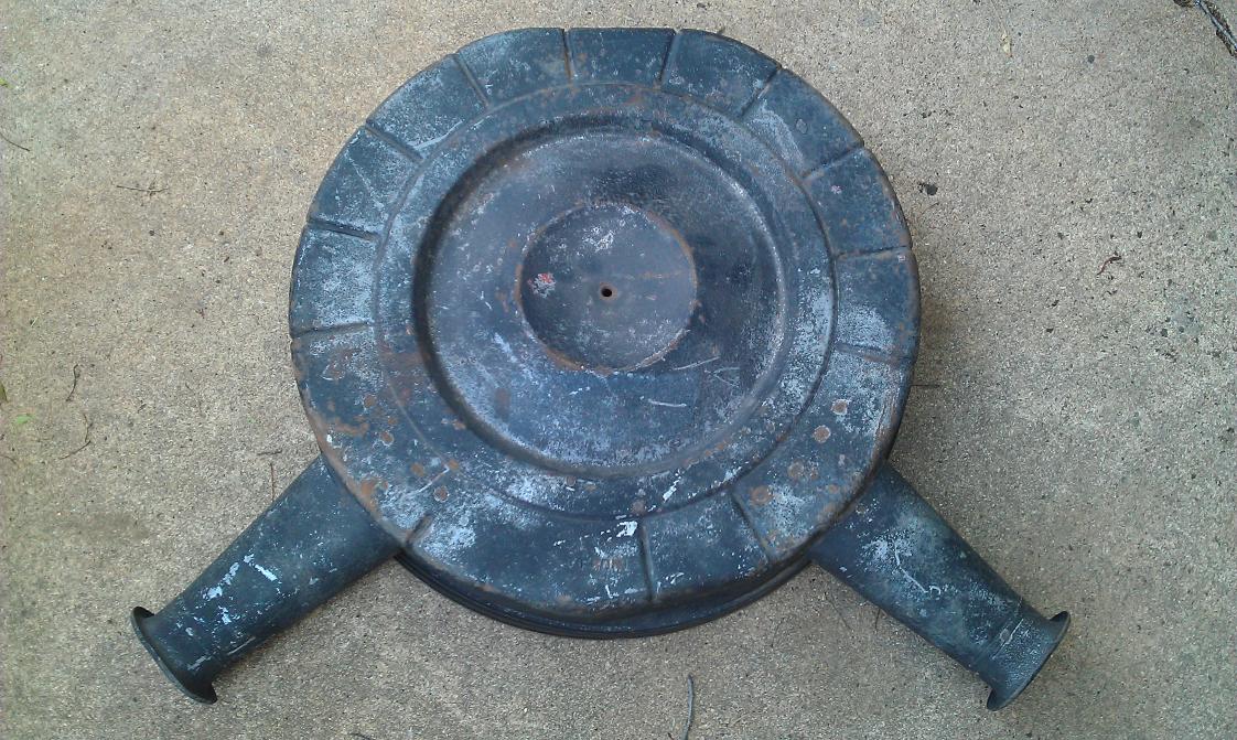

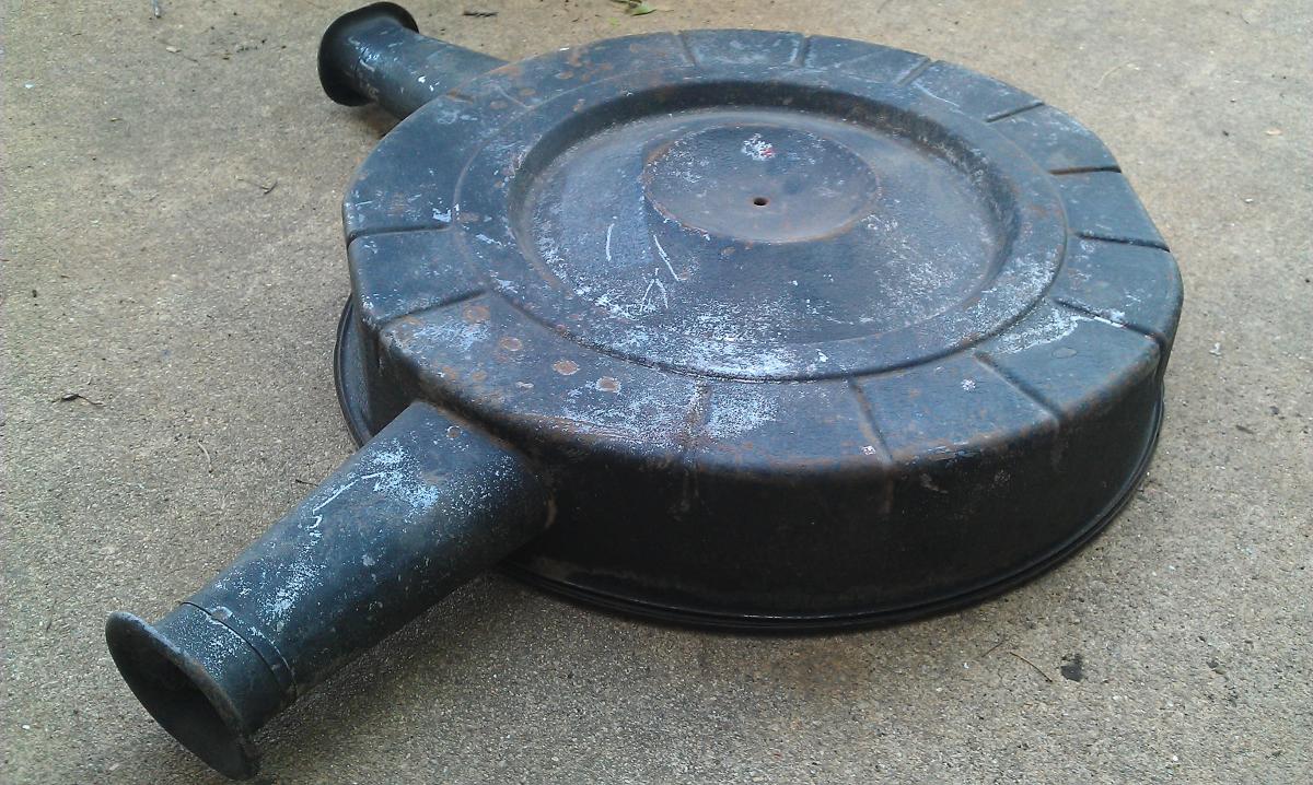

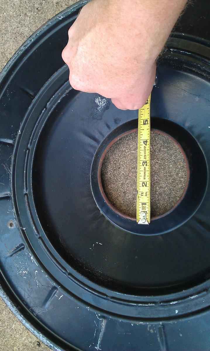

Hey everyone, I just got a dual snorkel air cleaner with the oval snorkels (not round) for my Coronet and am trying to figure out what it's from. I've done a lot of research on it and so far I'm thinking it's for a '67 GTX. There is no nipple on it to connect to the breather cap and the base is for the smaller diameter AFB carb. Can anyone tell me for certain?

Go to nick's garage website he has an excellent aircleaner identification page
A link to Nicks Garage: http://www.nicksgarage.com/aircleaner.htm
1967 440 4-Barrel. Used in the GTX, Coronet R/T and Charger. Not sure if it was used in other models or on the 383. Most likely this is for B-bodies only. Looks like '68-9 version except for different indent in front for A/C clearance. Cars with cleaner air package (CAP) had nipple on left snorkel to connect to breather cap.
NOTE: There are two different air cleaners in this style, one is taller than the other and uses a different base. See the photos below. They both use the same air filter element. Not sure yet what the exact application is but it appears that the B-body cars used the shorter one. If anyone has an explanation, please let me know.
From Nicks garage website.
Matt
