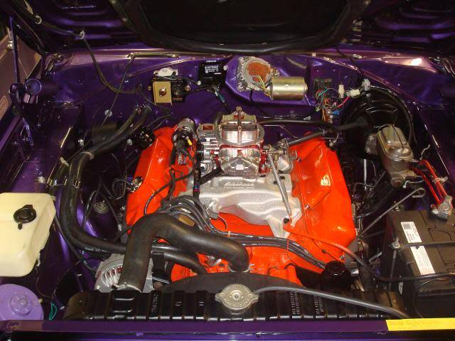

That's a great looking engine compartment kiwi and nicely engineered with the latest work.
Thanks Mr Tallhair :hello2: It may not be a 100 point car, but I try to make it as good as possible.

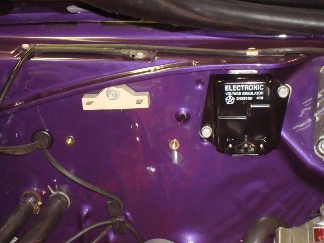

I see you have a non a/c car. If you going for the "could have been there from the factory" look, you have more room to work with than us a/c folks, there's just not quite enough room in that area for us :(
Always difficult consideration to drill into a virgin factory panel.

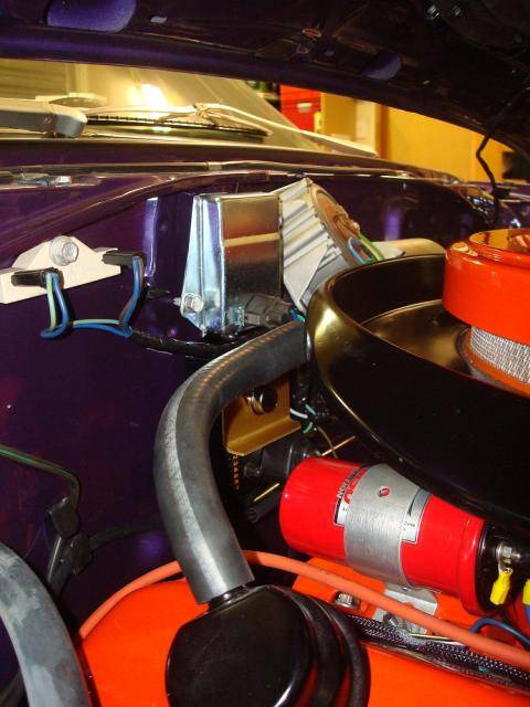

Another view - '70 GTX - still not available factory fitted in this year either...however it looks tidy there. :)

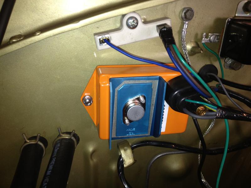

Ok, I got the set installed and went with the bonded solution, as I created a really nice ground solution with a 10ga wire setup. The car runs great. I highly recommend that if one wants to avoid punching holes in a firewall, to perform the steps that I vetted this weekend.IMG_2047[1].jpg

I made an aluminum template with a 1/2 inch gap for thermal clearance. I used a grey RTB silicone that helps bonding but will not vibrate loose over time. In fact, I made my grounding solution better by pre-scoring the star-washer all the way around the bolt fitting to ensure the zinc left particles in the paint. Perfect conductor. The bad-boy fired up on the first crank, no kidding.

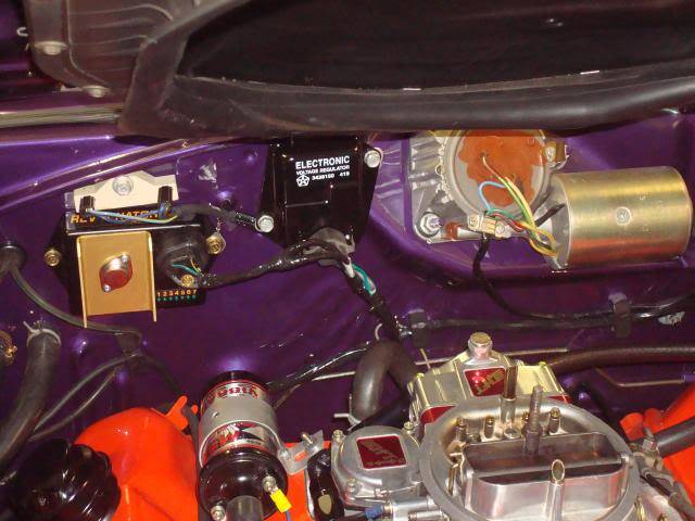

This is where I started out a few years ago by using a hole behind the Voltage Regulator that a previous owner had made. My MoPar boxes were stuck to the top of the heater box using Velcro adhesive squares. Hides the wiring nicely, but a PITA when problems need to be solved.
Fastforward to March this year, and i installed my Rev-n-nator. Tried to run in stealth mode to avoid the extra holes in the firewall....

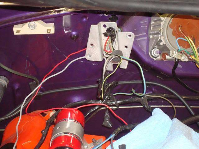

trouble is, that I felt that the bracket I had constructed might have been vibrating on the firewall - grounding was fine, I just wanted it firm on the steelwork. So I eventually did this a few weeks ago...
rewired with a new Mopar ECU loom...
and I am happy with that. It actually looks like it was meant to be there. Hope that helps somewhat.
