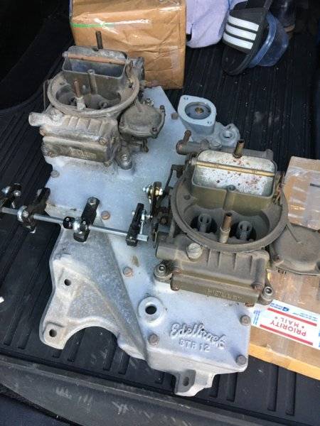

Finally after years of trying get one, I picked up an NOS today and the guy threw in some Holley 500's and a new linkage. It is going to go on top of my small block in my '65. Should look awesome!

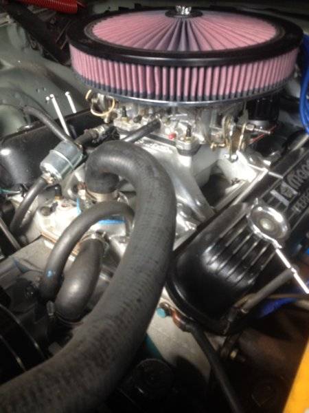

Do you remember how many years ago I had this RPM-AG done by you?
I don’t see any “discoloring “ do you?
View attachment 657169 View attachment 657170
I'd have to look at invoices Rob but would guess it's been more than a few years.

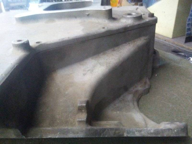

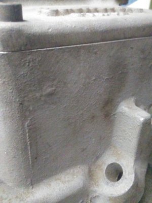

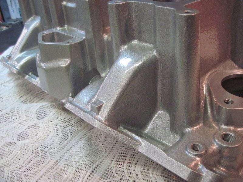

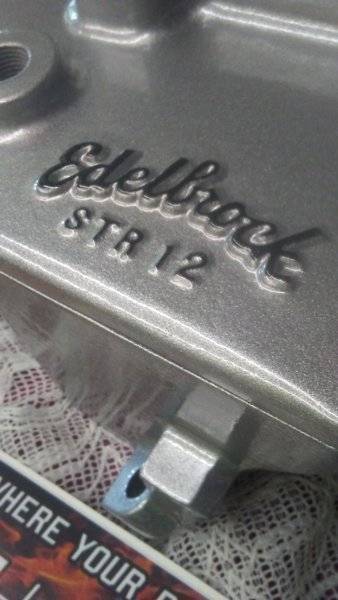

Here's a few pics for @hemidart1 to consider if you want to protect that sweet new score!! I finished it up a couple weeks ago.
This is what I started with.
20180821_145354.jpg 20180821_145500.jpg 20180821_145404.jpg 20180821_145254.jpg
Thank you Don!!! It needed a LOT of metal work but it turned out pretty nice. I can't wait to hear from my customer and see his mock up pics.
