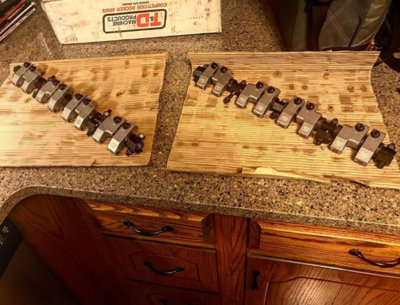

I Used victors on my 505, it’s still sitting on a stand in th garage but I can attest to what IQ52 said that they are a pain to set up. I had a wait on locks and retainers luckily I found a member here selling a set of T&D rockers that lives down the street from me. Expect to spend 1400 for a new set of t&d or you can go Harland sharp for around 1100.
