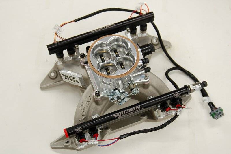

Here is the intake off my low deck 512. This started off as a Trick Flow intake then was fully ported by Wilson and then converted to EFI by Wilson. I probably have $2000 invested in the intake alone so it isn't exactly a cheap process.
What's the main driver for moving to efi?
My main driver was turbo charging the engine. I personally wouldn't mess with one that doesn't control timing.
I did mine in 2009 with a classic FAST system, there were no tpi at that time that could do what I wanted. The current ones are pretty impressive.
