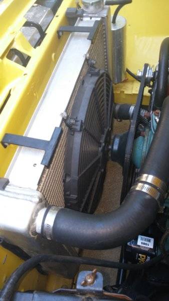

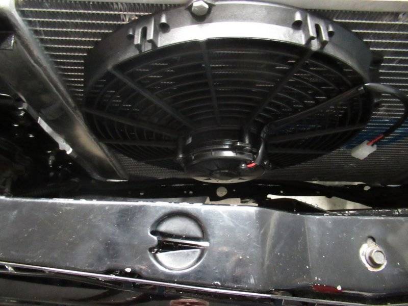

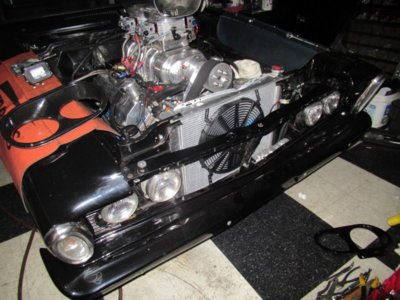

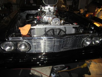

I have a $200 Afco aluminum triple pass radiator and a single multispeed Spal fan with no shroud.In 95* heat it might creep up to 190/195*.Normal is 180*

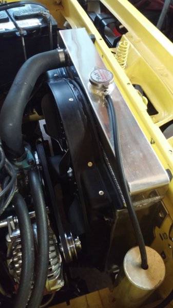

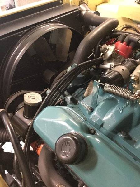

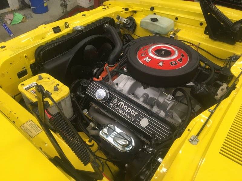

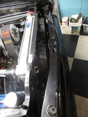

If you go electric, make sure you have a proper shroud to move the air properly through the radiator. The problem I had was with the big block in my '67 Barracuda, there was no room for a good fan setup and shroud as it would hit the water pump pulley. The 22" radiator did not allow for twin fans big enough to properly move enough air.
I switched out to a mechanical fan and shroud and my system works much better now. Before I would just get hotter and hotter unless moving down the road. Now the car can sit and idle with no overheating problems. I'll put some pics up of what was in the car when I bought it, and what I have now.

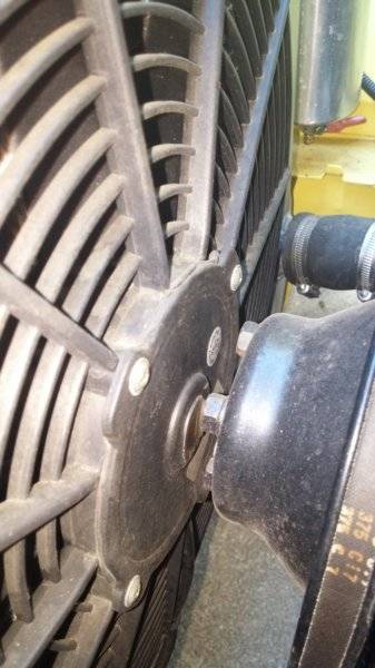

I'm running twin 11" Spal fans on a BeCool aluminum radiator to get around the water pump pulley, lots of cfm's.
Edited.... after looking them up I'm running twin 11" fans not 10".
I have a quality oem electric fan, but i do have it in a pusher, less efficient configuration. I must admit that i was playing with an electric water pump drive as well. The belt drive pump and fan solved all my self-inflicted problems.
I'm running twin 10" Spall fans on a BeCool aluminum radiator to get around the water pump pulley, lots of cfm's.

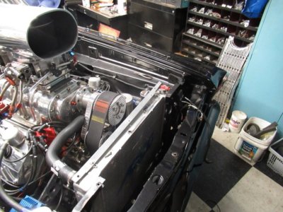

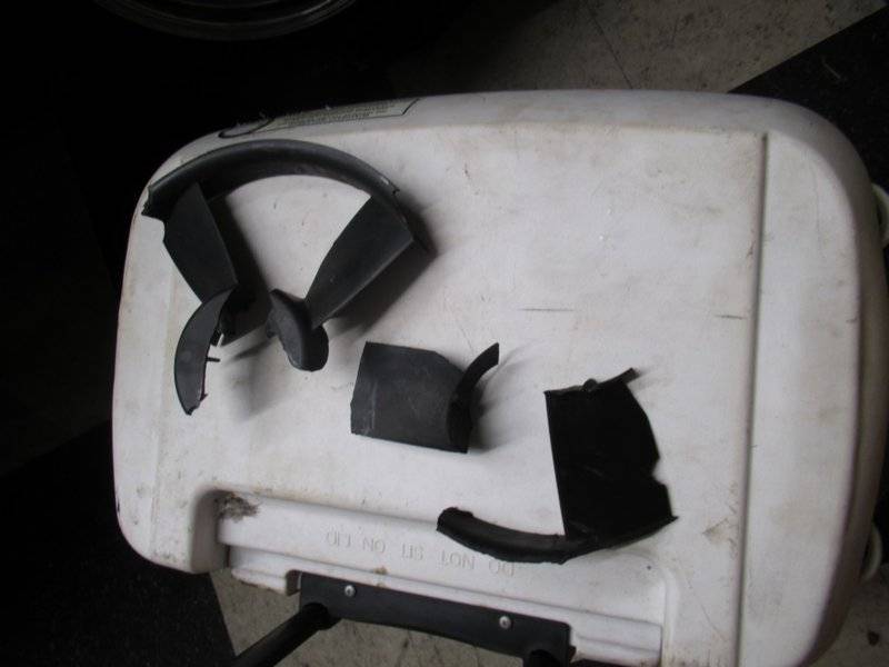

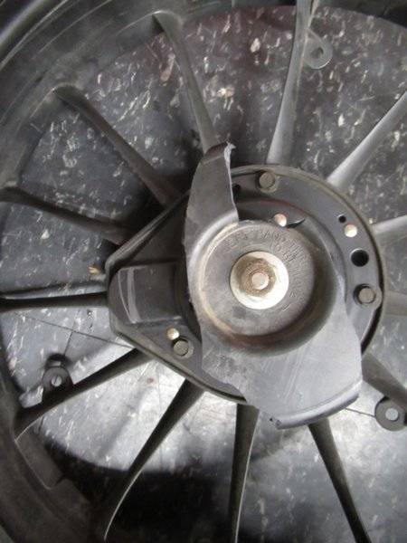

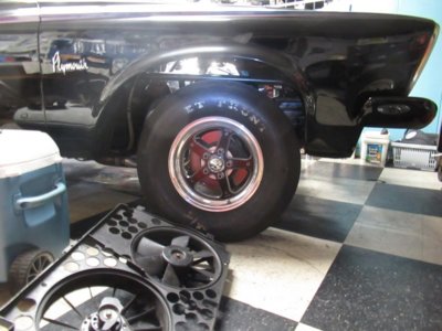

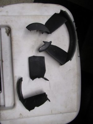

When I replace the stockish rad I used the twin fan set up I had for years and shed 200 lbs in the process.The way the plastic fans were situated one was directly in the path of incoming air,they had to be pushers.Anyway one fan centrifugally exploded with 140 mph air coming at it,,,,,,:lol:

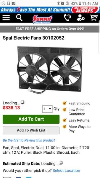

Not sure where your getting your info but that's far from the truth, here's what I'm running.... 2,720 CFM and that's just twin 11" fans!! I did my homework and purchased the right fan the first time.
