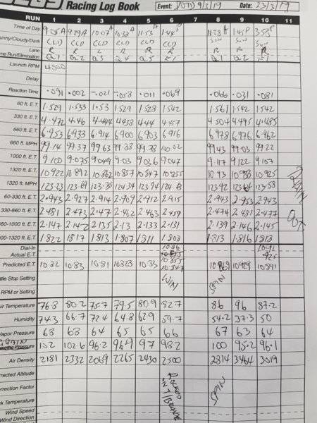

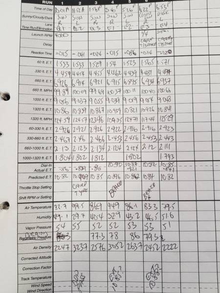

Here are 3 events in the last 2 months . Notice the water grains and temps
TC#1was last 3 rounds in 1 1/2hrs
DOTD was 5 qualifier runs in 3 hours
Pretty happy with that consistancy . Dont think the motor went to 185
Your results may vary
Tex

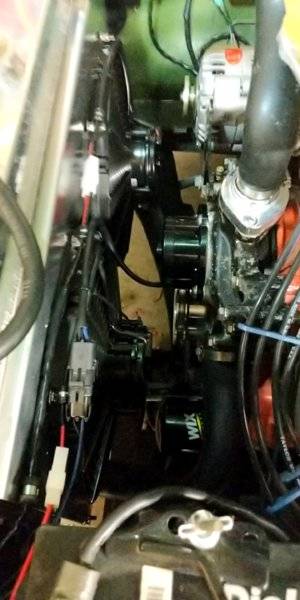

This is what I went with, I'm using 2 spal 12" fans and a meziere pump in the factory housing. The shroud was a direct bolt on to my Champion 26" radiator.
I had a similar set up in my cuda and never had any cooling issues and was able to regulate the temp very well. Made it a real nice bracket racing set up.
