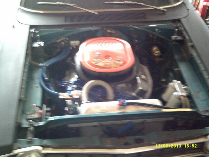

68 RR Perma-Cool Electric fan 16in. alum. 2950cfm prm-19115 $157.31 Summit.jpg
& 1- is a Prema-Cool #prm-19113 - $153 Summit Racing
1- 13" pusher/also has alum blade,
rated at 2600cfm (I see they are rated at 3000cfm now) in front of the rad.
slightly offset to the output top hose side of the rad.
for just in case if it gets hot 'in any scenario'
I'm not a big fan of the plastic blades, but that's just me...
68 RR Perma-Cool Electric fan 13 in. alum. in 3000cfm prm-19113 $153.05 Summit.jpg
(sorry the old photo sucks)

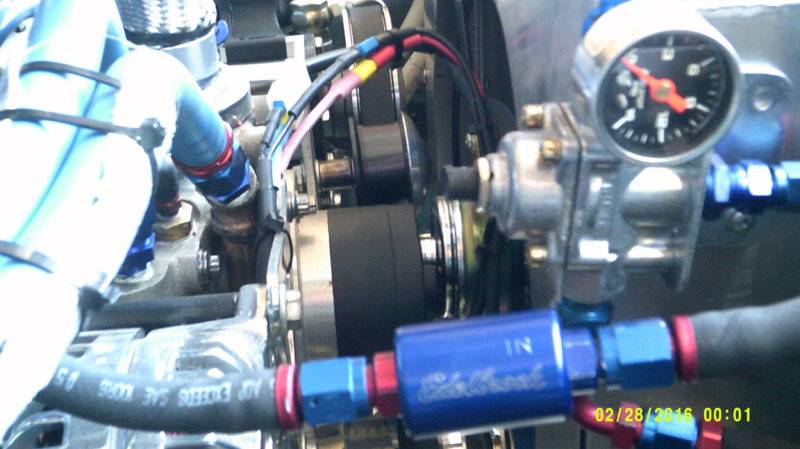

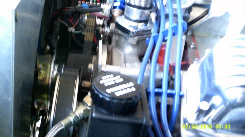

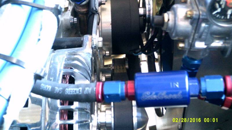

I also run an electric Pro-form 35-37gpm water-pump (was $190 Summit)
& I still had to restrict it's flow (of the water-pump)
(a 5/8" hole in a washer/made out of a piece of stainless steel,
inline where the thermostat normally would be)
so the water stays in the radiator long enough 'to actually cool it down',
& not just forced/flow thru it
mounted in a MoPar Perf. alum. w/p housing (sorry the old photos suck)
68 RR #37 Power Steering Pump for Unisteer rack & pinion serpintine belt ds.JPG
