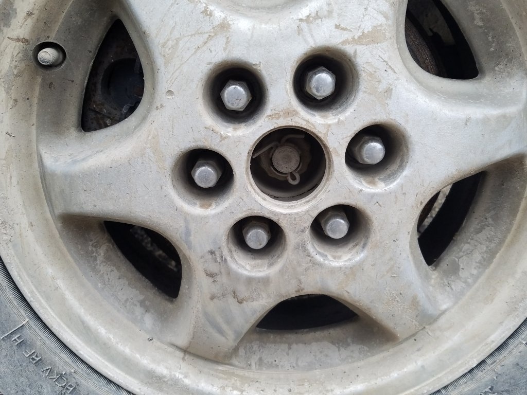

How about using a cutoff wheel to partially split lug nut. Not much room to grind.
Ya, my 4 1/2" grinder (most useful tool I ever bought) or die grinder with a cutoff wheel would have no problem.
If it's the driver side, what is the chance that the tire tech didn't realize it was left hand thread, broke off the stud, and replaced it with a right hand stud and didn't say anything? For this reason, I won't let the guys touch my wheels, I show up with my own tools and take off and put back on the wheels myself.
Took me an hour, but I didn't damage my Aluminum wheels.
