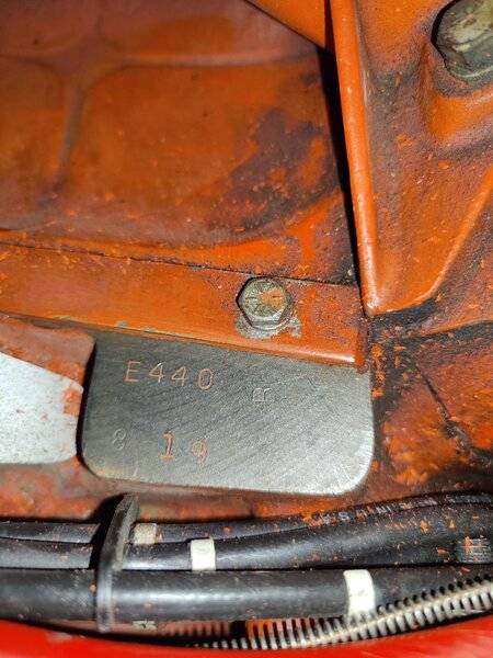

Hello so to my understanding the letter "b" it means its .10 undersized and is that a good or bad thing, im not an engine builder so im wondering why undersizing instead of oversizing what are the pros and cons of undersizing?
Its an engine from my 69 roadrunner i bough dont know much but it runs darn good
Regards fredrik
I think it is 0.010 and just means when the engine was assembled they had to go with undersized main and rod bearings to maintain proper clearances. I will let others expand on the pros and cons of it being that way from the factory.
If that is correct.....it's sure nothing to worry about, for a second! There are countless millions of cars running around, and well, with ground undersized crankshafts.
If it means anything, it means they checked clearances on your engine when it was assembled, and they made sure the clearances were right.
