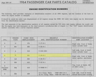

Yes because V = model year 1964. 36 = 361 CID
So a casting of 4/23/64 would be right.
6 12 would be the assembly date of June 12th (1964)

Not sure what to tell you on the block casting numbers.
The V stamp indicates an engine built for a 64 model year car. If it was a 65 it would be an "A" The casting date and assembly date fit together pretty well for installation in a 64 model year.
Let's remove all doubt. Measure the bore.

Well I finally got around to tearing apart the engine. Bore measures 4.108 So i believe its a 361
Theres one, don't believe everything you read!
2532130 casting listed as a 383, but built as a 361 based on the V36 stamping and your measured bore. Mopar back then you gotta luv'm
