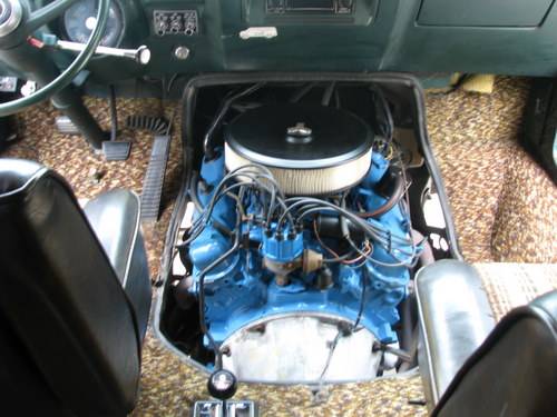

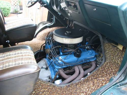

I've been changing the oil in my '75 Dodge B200 Van, 318 HD Pkg, since it was new. Until recently, I always used 10w40, conventional, but the last few years I've gone to the Syn-blend. Mine has the extra-capacity oil pan, needs 6 qts with a filter. It still all original, other than a Holley 500 & headers, 94K miles, runs strong, pushes 60 lbs pressure, so that's worked for me. Your car is probably 5qts, with the filter. Being further up North, I'd think 10w40, with the cooler temps also...
