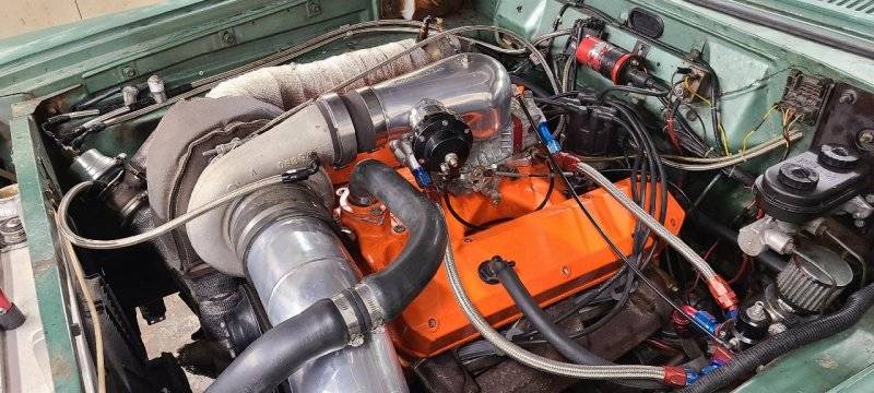

Oh yeah, that's a big *** turbo.
Honestly I interpreted a lot of the previous posts as people saying if your going to make a car fast, forget about having it streetable and that'd it'd be race-only. This makes a lot more sense on how a fast street car is almost easier to make as fast as it doesn't have to follow class rules, almost like its jailbroke
