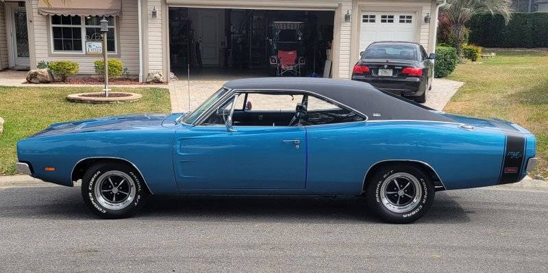

Newbe here. Yes, another thread asking about an exhaust recommendation.
I've read dozens of posts here about exhaust and all they do is make me more confused.
I'm hoping that the readership here can help me out on my exact situation.
I just purchased the car pictured. It has a 440 with headers, 2 1/2" exhaust with 20" long dynomax ultraflo mufflers.
Problem is, it is LOUD inside! Between 45 and 55mph you can't even have a conversation. After 15 minutes of driving, you have a headache!
I don't mind a nice rumble, but I need to at least hear myself think!
So what do you recommend, different mufflers or resonators?
And with mufflers or resonators, can you recommend specific ones that will quite it down a lot. ( I dont mind losing a few horsepower)
Also I've read of people recommending glasspacks (Like cherry bombs) as resonators. Would those be better or units designed as resonators?
Thanks to all!

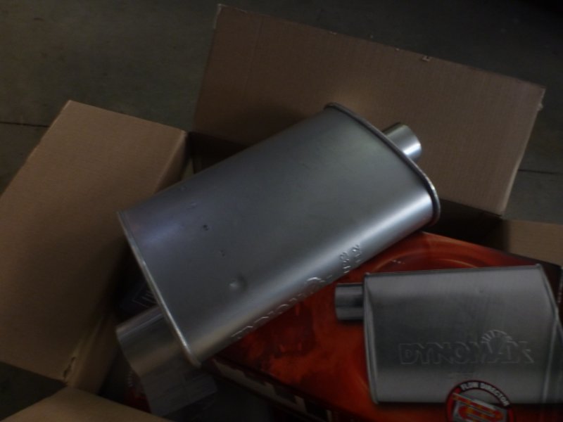

I changed the Wife's 340 Swinger from some no name style Turboflows to Dynomax Supers and it quieted it down a bit from the dragster that it was.
If you think those Dynoflows are too loud then I'd suggest the only cure is stock manifolds and full OE exhaust.
