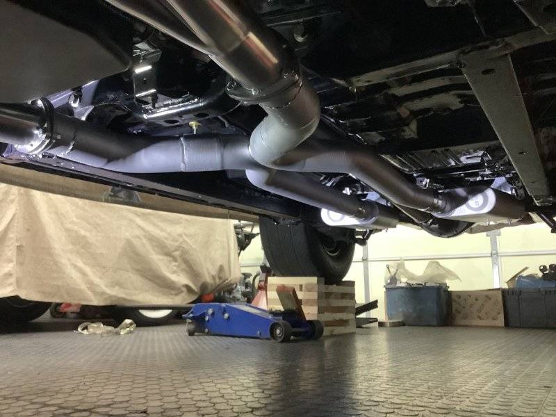

Local shop here really did a great job in my car. 2.5, H-pipe, and priced right. Very pleased.
