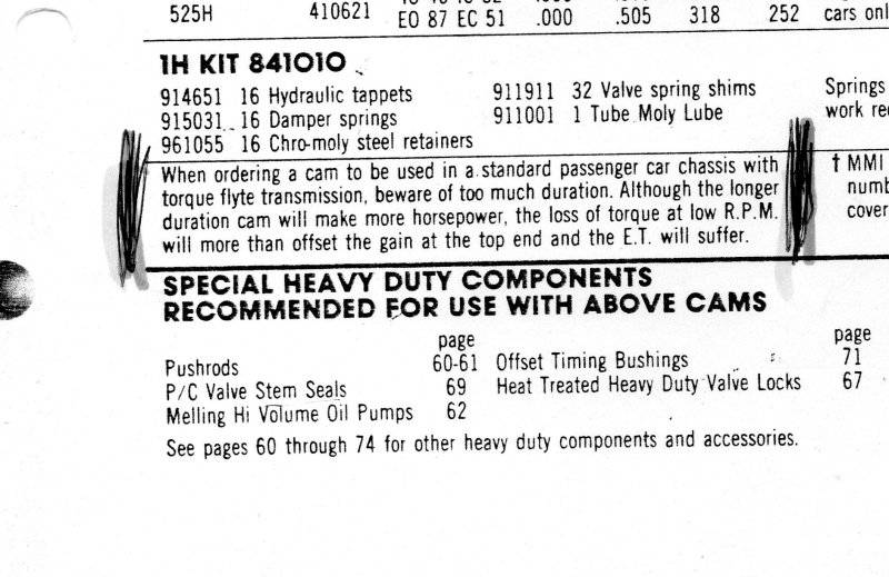

Below is a warning from Erson cams about excessive duration with the BB Chrys. The 350-400 Chrys engines have the highest rod/stroke ratio of all the big blocks......meaning they do not tolerate a lot of duration at lower rpms.

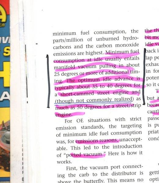

That cam will need at least 30* at idle [ yes, 30*!!! ] & probably closer to 45* for best idle.
This is what I'm working with, but for my edification what would be the upper limit of duration for a mopar big block?
242/248 is not there, but it’s within sight of max for a street runner.

I suspect your engine will be happiest with about 40ish degrees at idle. [ Advance the timing to 40* at idle & you will see what I mean ]. A 440 I built with slightly smaller cam [ idle timing is all about the cam.....] idles at 42-44*. This is probably too much for WOT, where 32-38* is reqd. The fix is quite easy. You use a dist with an adjustable vac adv. Get rid of the useless MSD dist & get a cheap Mopar dist from Summit that has an adj vac adv. The vac adv is connected to manifold vacuum [ MVA ]; that means, it is active at idle. The VA is load dependent, & drops to zero @ WOT. So if the VA unit adds 22*, you would set the initial [ static ] to 20-22*.
The Mopar dist can be used to trigger the 6AL.
Until you get the idle timing correct, you will never get optimum idle quality, vacuum & tip in performance.
I could give heaps of MVA success stories, here is one...
