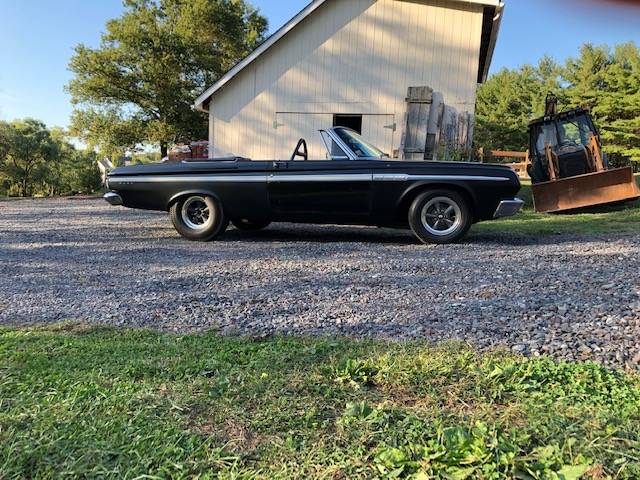

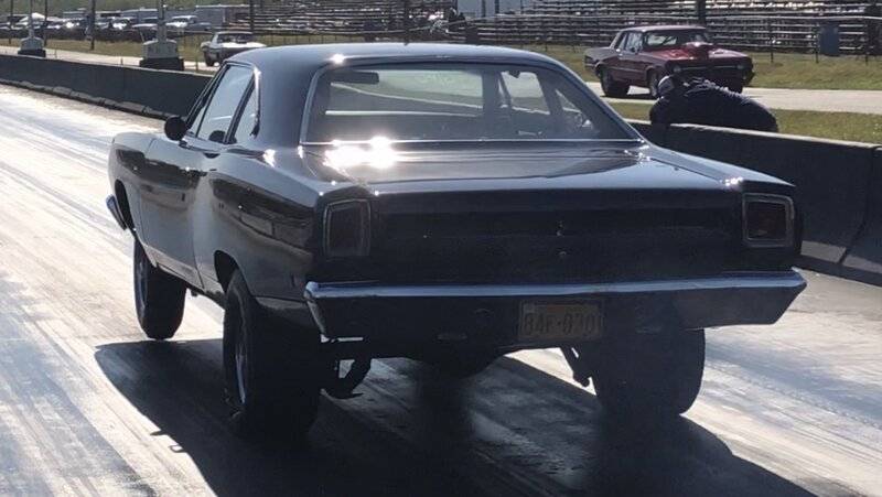

I just read through this whole thread. I think that the car is set up reasonably well where it is right now, at least for the engine. 3.23 gears, a tight converter, and low compression are not helping you. If you could add 3/4-1 full point (gaskets??) of compression, the car would likely respond well. Even before doing that, I'd install either different rear gears (3.91?) and a looser converter. I used to run the CH4B in my road runner with a Comp Cams Hydraulic Flat Tappet Cam of .501 lift. With 3.91 gears, a 3500 RPM converter of unknown manufacturer, and 9.5:1, the car would run 13.30's through the exhaust (not the setup in the below photo). It went into the high 12.70's with the pipes open. Your issue seems to be getting the engine into it's happy rpm range. The converter is what will do that for you. The gear change just makes it happen faster.
Changing gears to a numerically higher set would really wake your car up. I understand that everyone doesn't want drag strip gears, but the road runner I mentioned above was purchased new by my gf. He did not have another car. Drove it for 250,000 miles before the engine failed. That was all done with 3.91 gears. That gear set is now in our '64 Fury Convertible...that uses a CH4B and a Carter 750. That car is a 4-speed. Good luck. Borrow a set of gears from a buddy and have fun!
Changing gears to a numerically higher set would really wake your car up. I understand that everyone doesn't want drag strip gears, but the road runner I mentioned above was purchased new by my gf. He did not have another car. Drove it for 250,000 miles before the engine failed. That was all done with 3.91 gears. That gear set is now in our '64 Fury Convertible...that uses a CH4B and a Carter 750. That car is a 4-speed. Good luck. Borrow a set of gears from a buddy and have fun!View attachment 947437 View attachment 947440

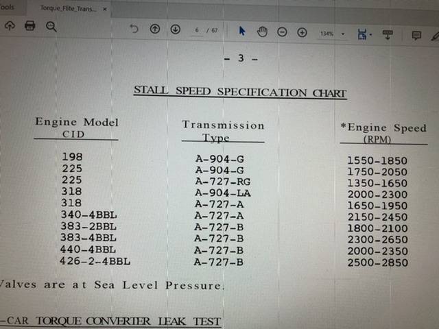

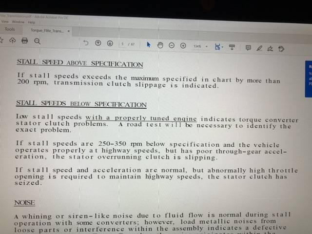

Advancing the cam helped, enough so that now I see a carburetor based pause. Fixing that shortly (accel nozzle). There was a Chrysler service bulletin about torqueflites back about ‘73 where they were explicit about the stall speeds. (See attachment). I bought a tach but have been busy so I haven’t put it in yet. I’m interested to see where this winds up, I have a distinct sense it’s low. Engine is nice and healthy though, just trying to tease out the correct expected behavior.
