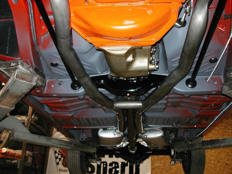

Did the 63 max wedge cars also have overspray on the primered undercarriages or where they completely painted on the underside?

Yep, the overspray is correct with the grey underside. Here is my 64 Dodge 330 on the rotisserie - factory style paint was done. It's a little hard to tell on the lighter colors like mine being white.
thanks for the reply; that solves another thing for me.

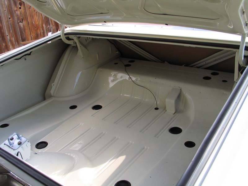

My '63 Savoy trunk floor...
I see your car has the sounddeadener on the inside of the quarters; was this an option on your car? Is your car a lightweightcar?
Not a lightweight car, but it is a 13.5cr '63 Savoy built Feb 14th, '63, so it missed the trunk mounted battery by a few weeks...
Hey RubyRedSavoy no I don't know for sure, and didn't see any signs of it in my car, but I just thought that the zolotone was factory since I have seen it quite a bit on factory style restorations on 62-65 B's. To tell you the truth I never looked it up to be sure!
Maybe it is a higher end Polara / Belvedere option?

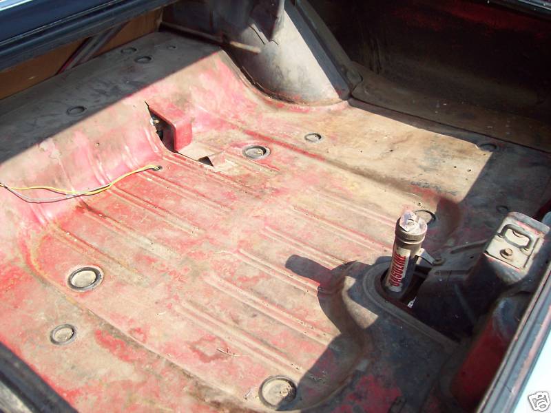

I have had several with factory Zolotone in the trunk. Perhaps it depends on which factory built the car?
IF Zolatone was applied, was it sprayed over primer or over body color paint? Need to do some detective work on my '63 Savoy....
