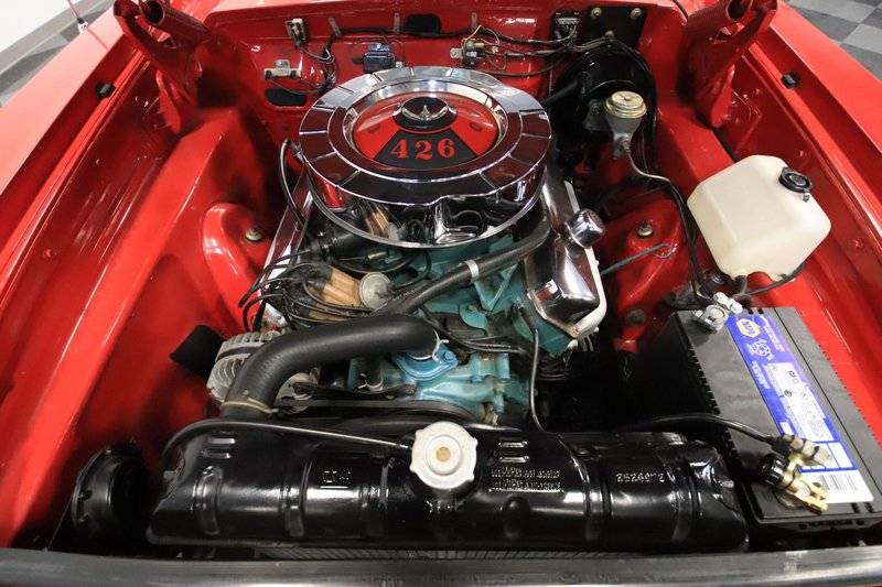

Factory photo of 64 426 engine bay
Had a 65 Fury with the 426 street wedge. No engine call out decals only the hood ornament that I remember. --
-- I believe that is correct. -- I had a, new, 65 Belvedere II, with a 426 Street Wedge. - 4 spd - bench seat - hardtop.
1965 Satellite with the 426-S used this decal, Commando 426..1964 426 did not come with the decal. This is an internet photo, not mine.
1964-65 426 Wedge 4-Barrel, also known as the Commando 426, 426 Street Wedge or 426-S. These were also used in the rare '64-66 Dodge CSS/HPP Pickup. Click here for more info on these trucks. The Plymouth versions (maybe only the '65 Fury) used a decal calling out the engine as "Commando 426". Cars and trucks with cleaner air package (CAP) had nipple to connect to breather cap.
Note, this air cleaner looks similar to 1967-early 1968 A-body 383 unit except that it is chrome and has a smaller area around the wingnut.

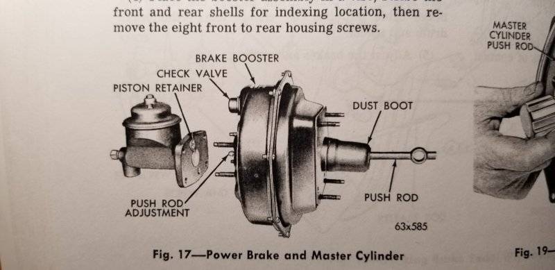

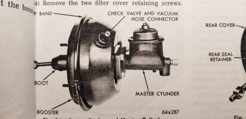

Looks like the brake booster on latest pictures are correct.
Chrysler Plymouth utilized two diff boosters in 64, the Bendix & the Midland Ross. The Midland Ross unit was used on the 64 Sport Fury and other B body's. #2525427
The Bendix unit.
Also the Midland Ross units were gold anodized while the Bendix were black.
