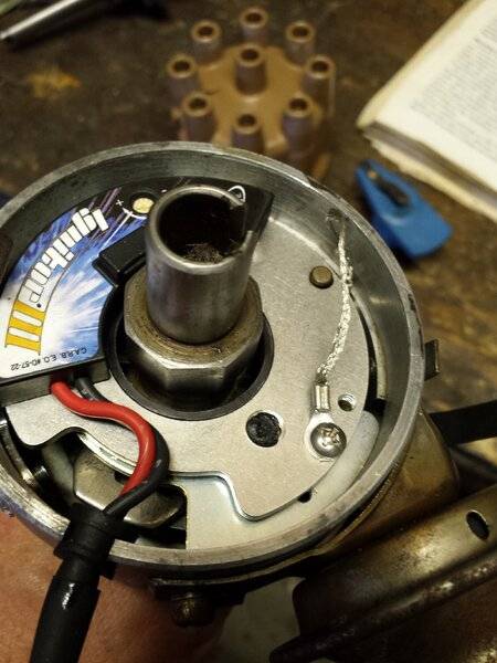

Pertronix III has a rev limiter, ballast bypass, goes in your distributor, uses vacuum advance. I have one in my GTX without issue since 2016.
I'm running 21 initial / 37 total and have vacuum advance hooked up.

Three wood , was this in a points distributor , or a factory electronic ignition distributor ?
I should clarify , are these available for factory electronic distributors , those of us that have done conversions
Points distributor. Pull the old advance plate/points out and put the Pertronix III in its place. The system activates on the cam lobe on the distributor shaft.
