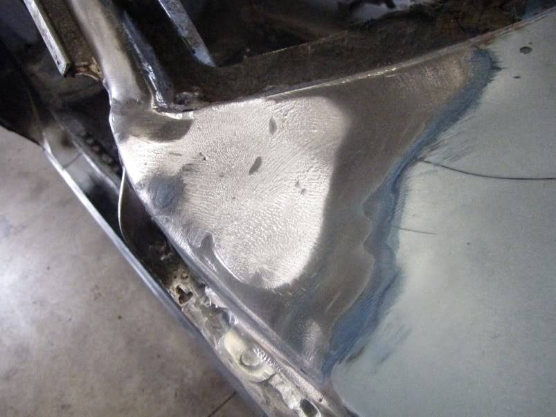

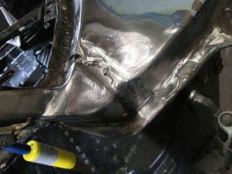

A-Pillar is leaded in just like the quarter to roof and quarter to rocker transition.
A little Map Gas and she's melted out

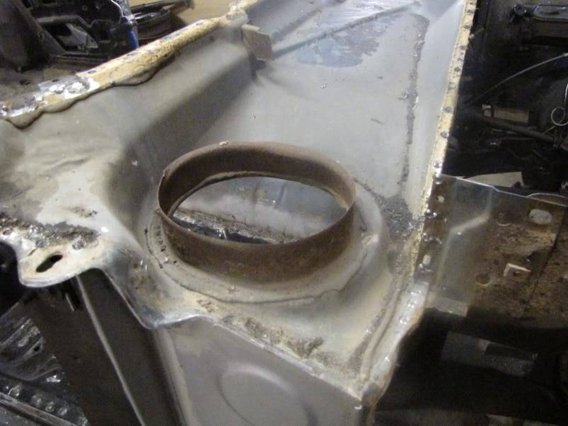

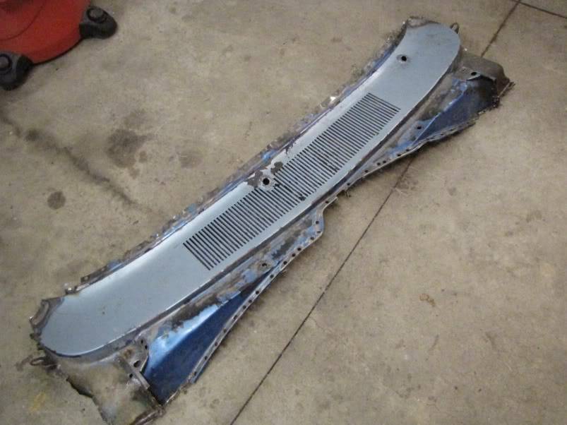

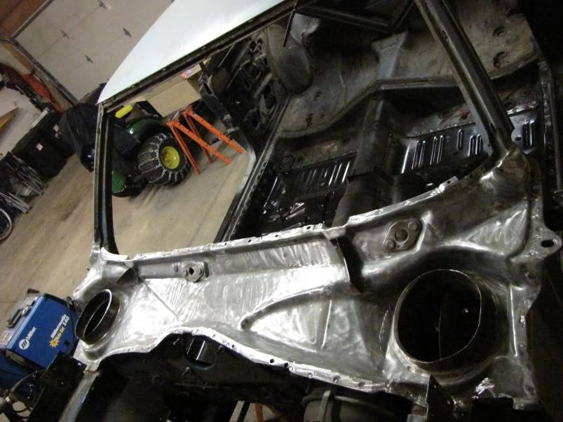

After a healthy dose of drilling out spot welds and grinding out welds by the pillar, old cowl is off..

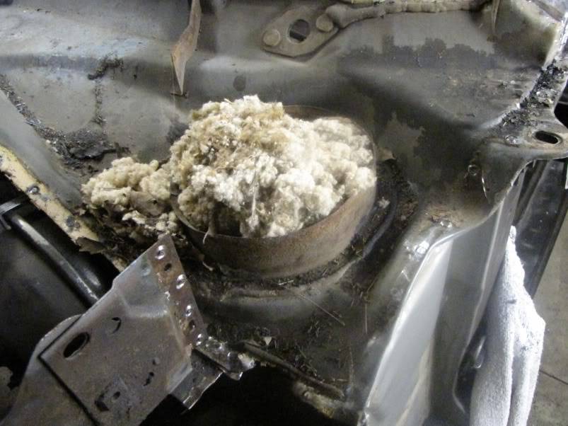

When I got off the cowl I was Stunned!!!! I cannot believe it wasn't rotton under there. Real unexpected! Just another mouse hotel..

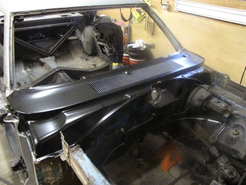

Test fit the new AMD cowl..Fit up pretty dang good, but there will to be some tweaking here and there.
Got the cowl all cleaned up...Ready to coat and apply new sealer around pleneum's. After that primer and finally some body color!!
You lucked out Prop, it looks pretty solid under there! You using panel adhesive on the upper cowl?
Damn!! I've never taken a cowl off anything before.
Premo mouse nest you found there, that would have smelled nice when you hit the heater huh? :grin:
Going with metal 2 metal on the cowl to a-pillar seam for this too?
Sure did luck out Matt! I'll be sealing the cowl with a weldable sealant then the typical welding back on... Here's the stuff I use:
I did not decide yet to either go with Duraglass or metal to metal there Dave... Probably metal to metal I imagine
Your right, glad I found the mouse house before going down the road and opening the vent.......Chocolate sprinkles and Pee ridin rodent stuffing everywhere!

That must be the same mouse, that is exactly how the mouse filled mine lol. Although I went the lazy way and just took the three minutes and pulled the vent tube down inside the car and checked for rust and removed the little guys nest. You can see up there good with the vent tube pulled out.

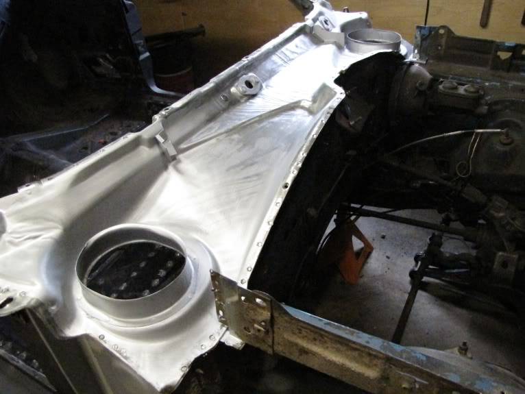

Worked off and on the roadrunner this weekend...

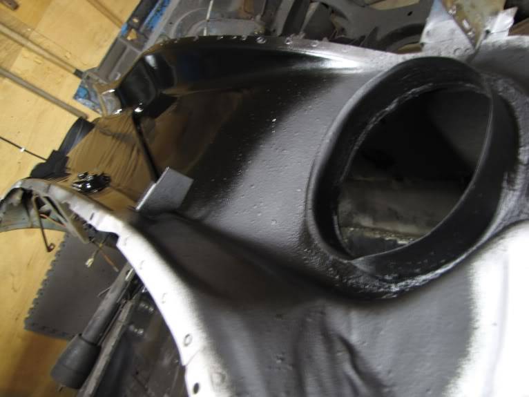

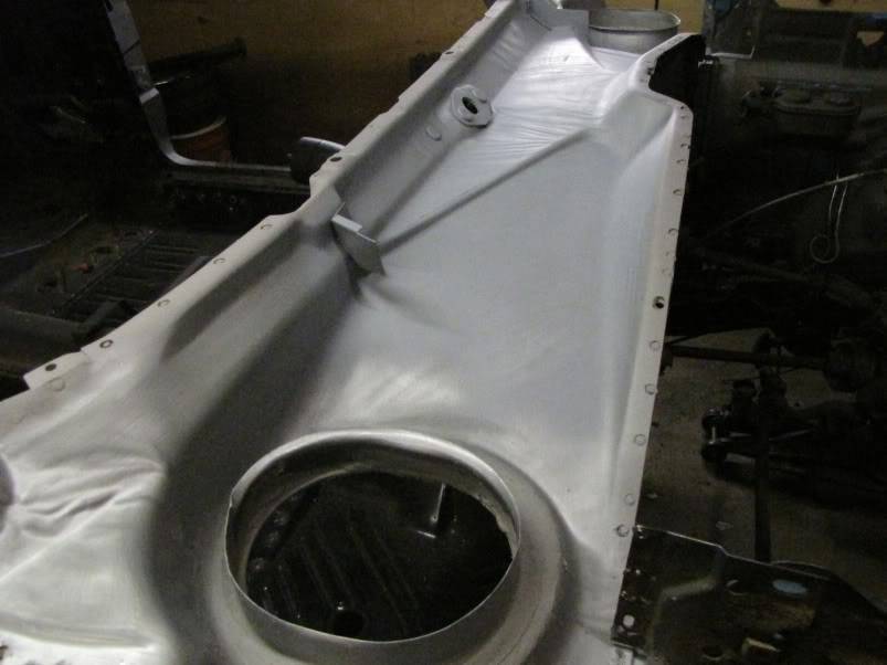

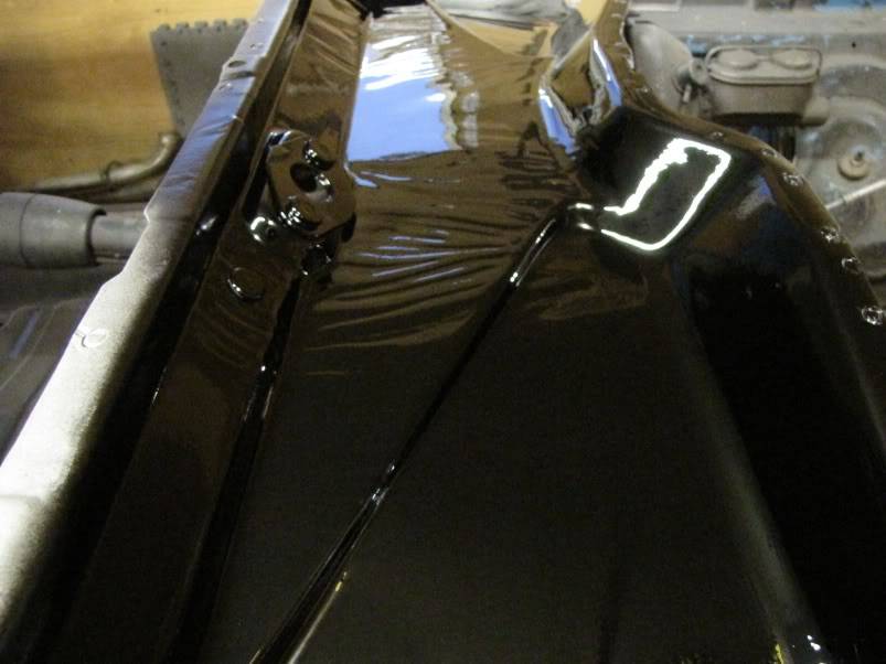

I rust Bullet coated around the Pleneum areas and brought down the cented of the inner cowl with some 150 grit, getting ready for primer..
Mixed up some PPG 2K Urethane primer I mixed as a sealer, sprayed and then wet sanded down with some 500 Grit in the center section of the inner cowl where actual body color paint is going to be applied. I applied 3M brushable seam sealer around the pleneum base on the outside and inside. After that, sprayed some weld through primer on the mating lips that will be welded to the outer cowl.

After all dried, I applied 3M Body Schultz around the painted areas on the inner cowl

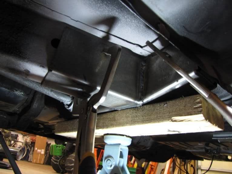

As well as getting the inner cowl all set for the outer cowl to go on, I got one of the Auto Rust Technicians "Safe T Cap" jigged up and welded on the torsion bar, front rail junction. They accidently sent me two left side caps, so I should receive and weld on the right side some time this week.

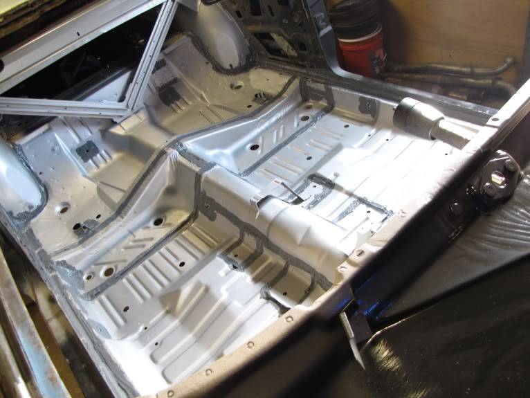

Wire wheeled down to bare metal the entire interior pan areas up to the start of the trunk pan and scuffed down the E-Coat on the new pans with some 180 Grit, getting ready for a layer of rust bullet..
Got the whole area coated and then applied Evercoat seam sealer to all the seams. I have to admit the evercoat seam sealer lays on much easier than the 3M.
